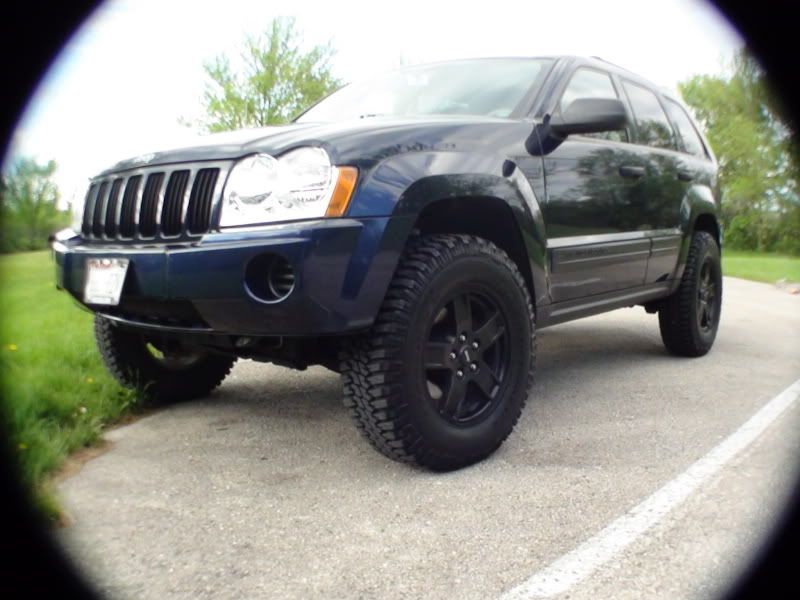

could just scuff it up and smooth any imperfections with sand paper. i did a set that came out really good like that. prep time was only 2 hours. On my grand cherokee i sand blasted them and used an epoxy primer on the bare alumium ( only stuff i found that holds up on bare aluminum) then just did a cheap semi flat black tractor implement paint.
