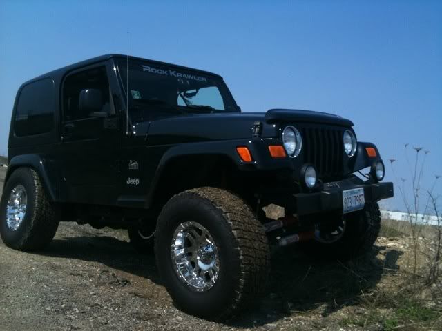

03TJJeeper
Location: bartlett Il
Posts: 164
Go with the ones i have. moto metals, i forget the model.
03TJJeeper is offline

Nice jeep!!!
birds1969 is offline
