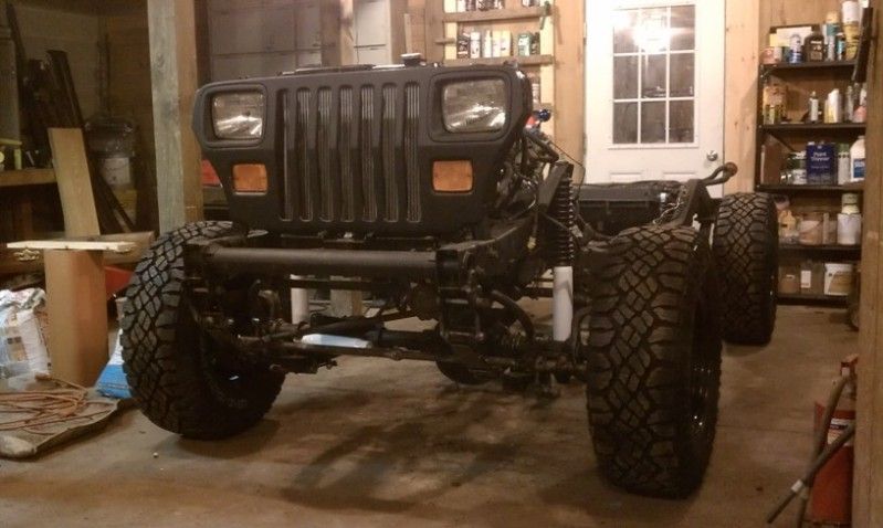

Much appreciated on the quick replies. I'd much rather have 31's if I can manage it on the stock no problem. Half of ppl say they can rub, the other half say no problem. I wouldn't crank it anyway, so I'm hoping I'd be good.
I like the Goodyear Durtrac's.. Although a tire place by me mentioned Dynastorm 31's I can get for $150 each. Any other suggestions?
If its anything to you... the Duratrac's always give the impression of a larger tire. Maybe the lugs make them look bigger I don't know. I run them on my Titan and on my YJ. Here they are in 31" form. Also, I paid $171 a tire from Tirerack (local pickup) plus got a $100 rebate from Treadlightly

post #19 of 20 Old 10-01-2012, 02:49 PM
senecak19
Location: South Hadley
Posts: 119
Different view...
