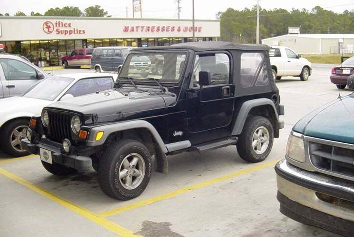

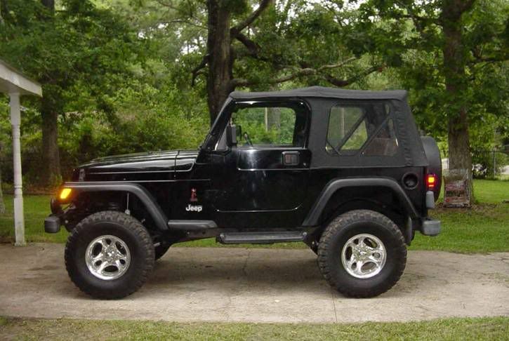

So, here they finally are:
Before:
and After:
It really needed the change!

Did you have to mod your gears or anything other than the lift to get these tires? Are they 32's or 33's?
Also, do you notice much of a decrease in performance?

I actually just had to edit the title (I originally wrote 32x12.50). They are 33x12.50's. The gears are the stock 3.73's. They work out really well. I stopped at 33x12.50's because of the dana 35 rear end. The top speed is dropped to right around 80 mph because of the tire change. All in all, it's a really good combination, and we are really satisfied. I'm glad we did it.

The labor cost me nothing because I did it my driveway, but it did cost me my weekends off for a couple of weekends. I was able to do it all with just the wife's help, but it took a long time. I have done one minor lift kit before (spindles and leaf spring blocks), but nothing like this. I started by putting in a lockright locker up front one weekend (that took way longer than most). If I had to guess, I probably saved around $1,500 to do it myself. Pulling the front differential would have probably been a few hundred to change the spider gears. Putting the body lift on and changing the motor mounts probably would have been a few hundred as well. The biggest labor savings probably came from doing the superflex kit. That thing just has so many steps. I put on the adj. front track bar as well, so the entire process seemed to take forever. From start to finish on just the suspension lift part took a solid 2 days. I may be a little slow, but I know it was done right. There are some really good write-ups at 4x4xplor.com, and a bunch of others on the board have done them, so you can get help if you run into a snag. That's exactly why I went with the Rubicon Express.
As for the fender flares, a single can of Krylon Fusion for about $3 or $4 should do the trick. I wouldn't even mess with taking off the flares. The little nuts on the back are PITA! Just carefully insert some paper and tape it off real well, and you should have no problems spraying it. The old gray flares were just plain horrible.
