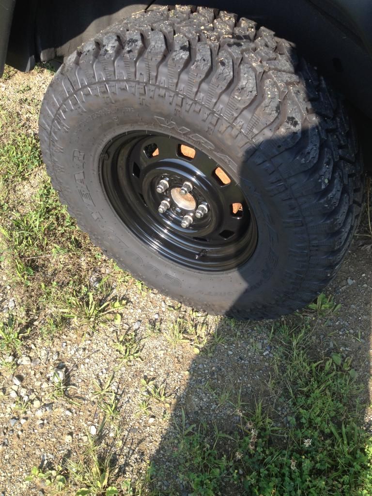

I ended up doing my wheels with this stuff:
http://www.walmart.com/ip/Rust-Oleum...Black/23760381
I ran a scotch brite pad on em, cleaned up, primed em, and then put on 6 or so coats of that paint. It goes on pretty thick and is real tough when dry. I dropped a lug nuts and the wrench on the wheel once and it did not chip at all. Very strong coating. It almost looks like a brand new powdercoated wheel:

That turned out good.
I used just the plain old rattle can rust oleum to paint my wheels and Rubi rails. It's holding up fine. Now I need to yank off my sliders and clean those up as they are showing their age because of trail abuse.
