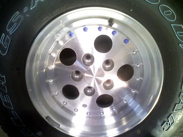

Anybody know what the bolt pattern and backspacing is on this wheel?
I believe it came off of a TJ?
I bought them about a year ago from a TJ guy and now im selling the rims and tires, and need to know the bolt pattern and backspacing... Someone know?
Thanks

I believe they are the same as all TJ wheels... 4.5" bolt pattern for sure... not sure of the backspacing 100% though

Backspacing for the stock Gambler wheel is 5.25".

Measure it. Lay a straight edge across the outermost lip of the backside metal, just at the rubber. Then measure backspace distance to the flat back side of the lug hole area.

If it is a stock TJ Gambler wheel (which it appears to be), it will be 5 on 4.5" bolt pattern, 15x8, with 5.25" of backspacing.
As JeeperDon said, backspacing can be measured. Here's a picture showing what he explained:
