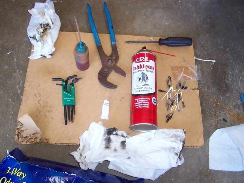

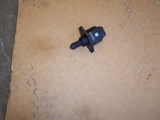

Steve's IAC fix.
Problem: high rpms all week. Engine idles at 1250 rpms hot or cold. Not a big issue but this will burn more gas while idling. The normal idle speed for the 4.0L engine is 650 rpms, so mine about twice that.
Cure: remove the Idle Air Control Valve (the IAC) and clean carbon from it and the passage ways on the IAC to Intake Manifold housing.
The PCM has Inputs and Outputs. The Inputs are from sensors like the temperature and the throttle position and the outputs are for controlling actuators like the IAC motor and fuel injectors.
In the Throttle body the butterfly (or throttle plate) is completely closed at idle. Above and below the butterfly is a channel or bypass. This bypass is the only way for air to enter the manifold during idle. The butterfly only opens when you touch the gas pedal. In this channel/bypass is a plunger for controlling the airflow rate. A stepper motor moves a plunger in & out. This plunger/motor combo is the Idle Air Control Motor Valve (IAC). Air for start-up and idling is controlled by the PCM. It tells the IAC how much to open/close to let air into the intake manifold.
The IAC will move to a Home position when the ignition key is turned to Run (not start). Mine defaults or is extended 1.0 inches with everything off and moved in 3/16 “ with the key in the run position.
Location:
tools needed:
coated with carbon:
Clean IAC:
Clean:
Again, thanks to greasefingers for the informative post.

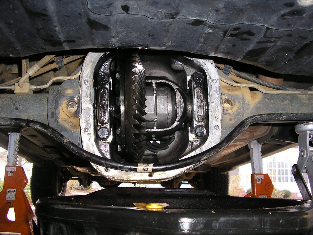

I finished this install last night, and I just got the jeep back on the ground this morning. I have a brief write-up for the WJ install (the directions that come with the Aussie are REALLY good so I'm just adding a few WJ specific things) and my driving impressions.
Items you will need:
Basic socket set (particulary 6mm, 13mm, 15mm, and 18mm sockets)
Feeler gauge (enough to measure from .006" to .170")
Mallet
Crowbar, Breaker Bar (for those stubborn things...)
Floorjack, jackstands
Gear oil (I used 85w140)
Brake cleaner
First off, loosen the lug nuts on the rear wheels a half turn, raise the jeep, remove rear wheels, place jackstands under unibody, and let axle droop. I disconnected the rear swaybar endlinks to let the axle drop further. Also, place the Transfer Case in Neutral.
Remove the diff cover (held on by 10 - 13mm bolts) and drain fliud. Clean inside of diff with brake cleaner. You should be left with something like this:
Next, remove the pinion shaft from the carrier. It is held in by a cross pin (a 6mm hex socket will extract the cross pin if you are careful).
Once you have removed the cross bolt, rotate the rear driveshaft (which will rotate the carrier) and the pinion shaft will fall out. You can now remove the spider gears by hand.

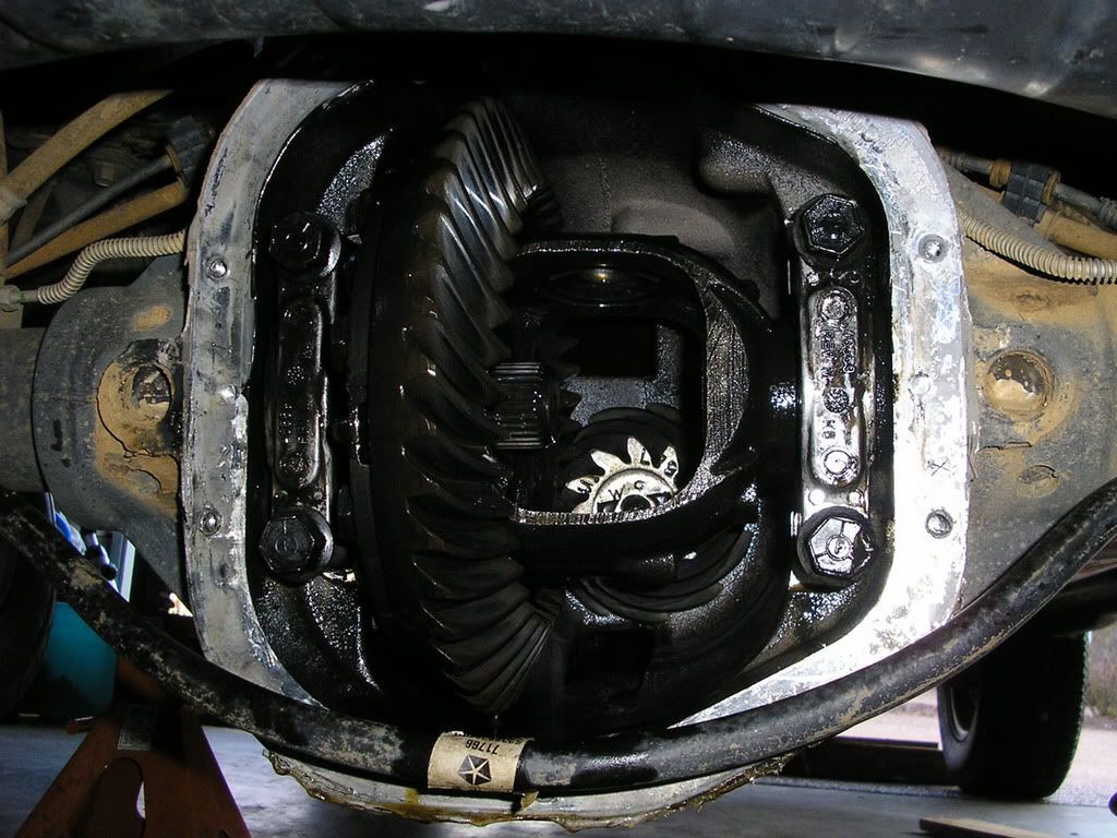

The side gears must now be removed. To remove these, you must pull an axle shaft out about an inch. (I pulled the passenger side). First, remove the caliper from the brake rotor (held on by 2 18mm bolts). Tie the caliper up and out of the way with zip ties - do NOT let it hang by the brake line! Next, the brake rotor must be removed. This will take a good amount of PB Blaster and some good whacks with a mallet. Also, be sure that the emergency brake is not keeping the caliper on.
With the brakes out of the way, remove the 4 15mm nuts attaching the hub assembly to the axle housing (these are on the axle side, "behind" the brake dust shield). The axle shaft will now slide out:
The side gears can now be removed from the differential.
Here is a shot of the now-empty carrier:
From here, just follow the Aussie instructions. Remove the thrust washers from the stock side gears and place them on the Aussie side gears. Grease the side gears and spacers up and place them in the carrier. Put the pinion shaft back in and take a measurement with a feeler gauge to check the tolerance. If it is ok (between .006" - .020") then proceed with the installation. Follow the directions in the section titled "Thin Ring Gear" (this is the main difference from the ZJ install - the ZJ D44A has C-Clips to retain the axles and the WJ D44A does not).
Once you are done with the install, check your center tolerance with a set of feeler gauges (should be between .145" - .170" gap). Now you're done! You can try to do the "unlock test" that the Aussie directions speak of, but I couldn't get the locker to unlock with my bare hands.
Here's a picture installed:
Put the cover back on, fill with gear oil, get everything reconnected and tires back on, and go for a drive!
