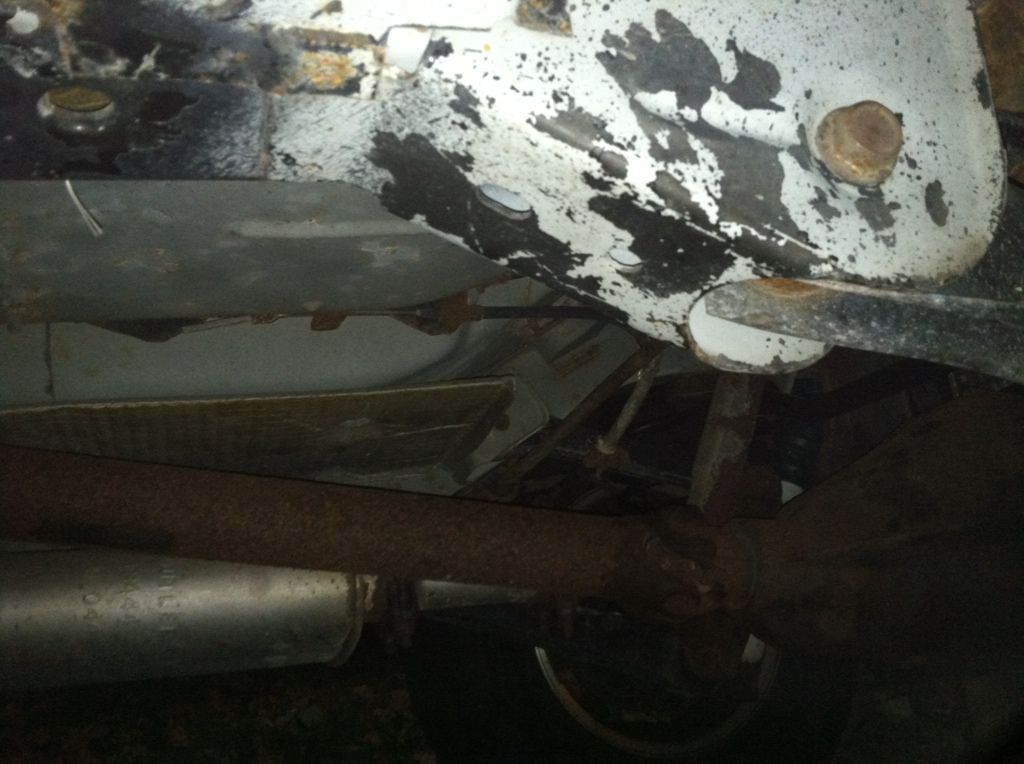

There's no lateral or vertical play in either drive shaft. I'll put pics below.
So I want the rear dif pointed up more and the front dif pointed down more correct?
Can you pull the front drive shaft on the 242nv I hear different things

The rear diff pinion should be parallel to the t case output. The front diff pinion should be pointed at the tcase output.
