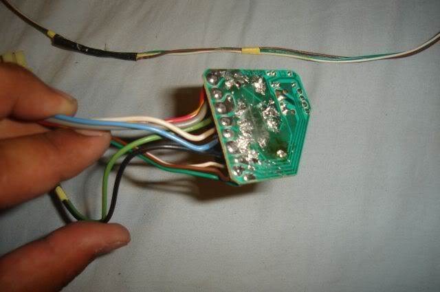

i had started a thread on this but cant find it...if you hear a click..most likely it will be this part..it is to the left of the motor...in a black box..ill look for my thread.

Found it here it is...this did fix my problem...the reason it would only go up and down was because i had a bunch of leaves in my sunroof rails...cleaned that out and works great ever since.

Well I just bit the bullet and took the headliner out this morning and determined exactly what cAcHe96 said it was, that module, or whatever it actually is seems to be the problem. I bypassed all the switched and hooked the motor directly to a battery and was able to close the sunroof, now all I have to do is replace the headliner, that module and then put it all back together, I guess Ill be driving without a headliner for a while.

While working on my 1997 GC Limited sun-roof, I found that when activating the console open close switch if there is clicking sound at the control board near the gear motor, that the problem is the micro-switch on the driver's side. This part is called the sun-roof position switch. If you live in the UK, I am pretty sure that is it is a Cherry Mfr. Part No.NM09-0045. Too bad i live in the USA, where it is not available.
http://uk.rs-online.com/web/p/produc...part-_-1977709
To bypass the switch for an emergency close procedure, do the following. Disconnect the pigtail connector going to the switch. Short the center pin with one of the others, then try the console switch. If that does not work, short the center pin with the other pin instead and activate the console switch again. Be careful not to over travel, as it may cause other damage.
