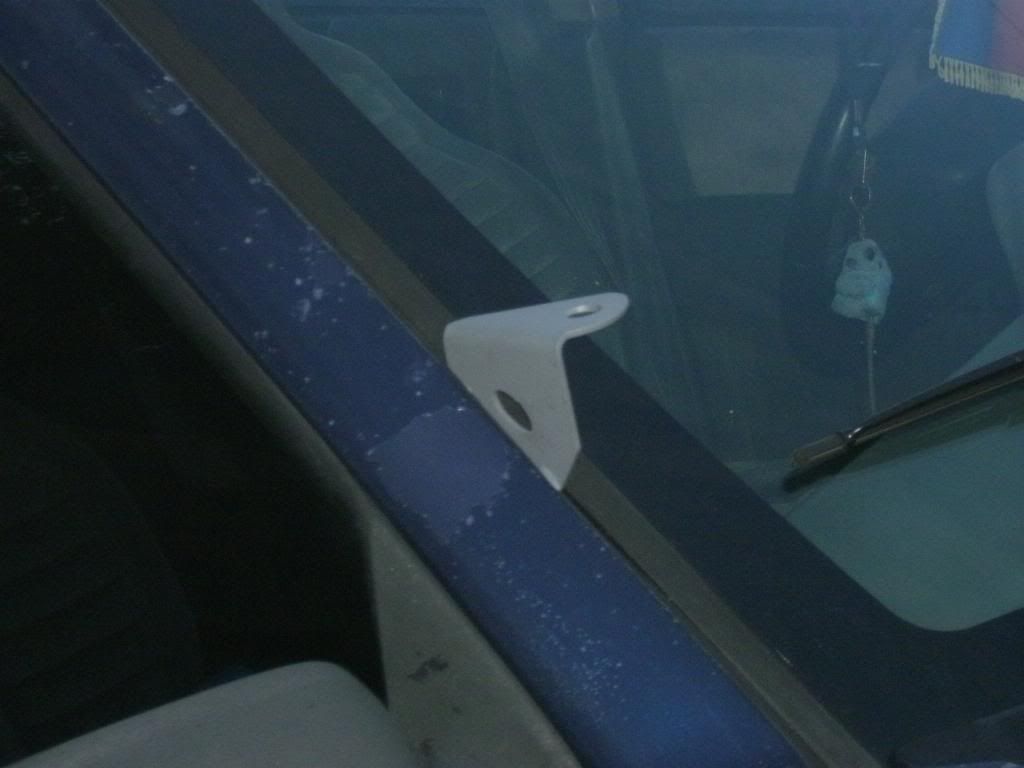

Door opened with weatherstripping pulled back.
Weatherstripping on
Door closed
1993 ZJ 4.0 Laredo

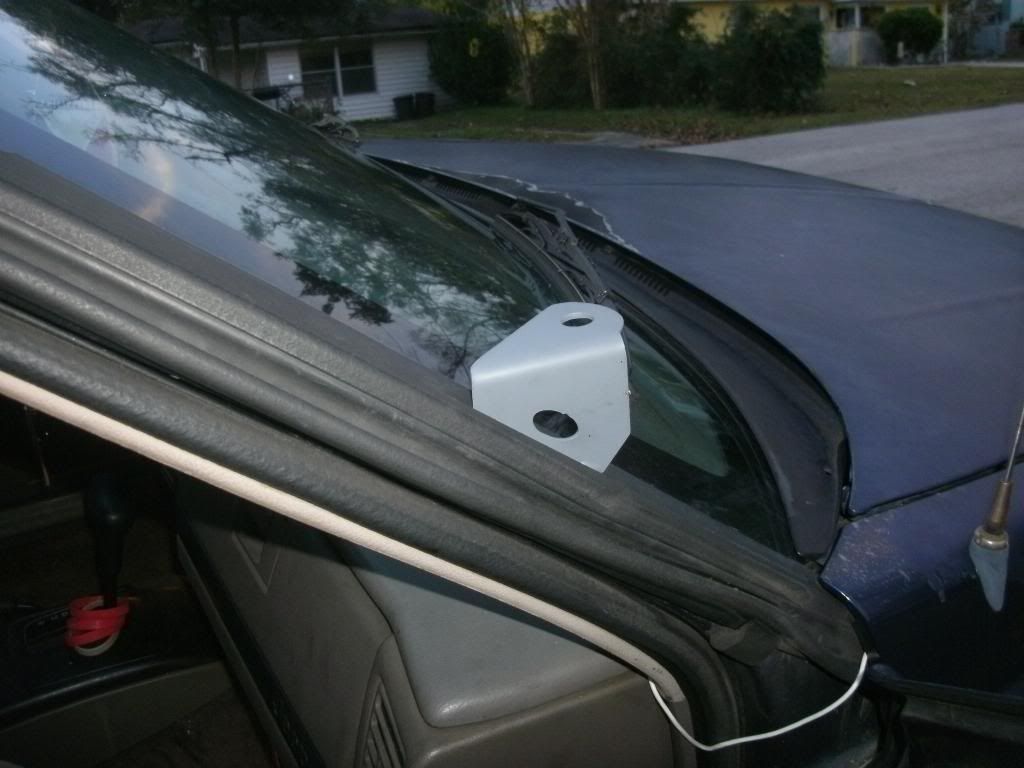

post #73 of 83 Old 12-28-2012, 04:36 PM
fljeepney
Location: Jacksonville
Posts: 653
I was test fitting the right side.I had to send one back to Detours due to them sending me two right sides,no left side,lol,no worries.
Will have them painted and mounted soon.

Can you mount these as high or low as you want on the a pilar? I might make some this spring or buy them if you can mount them lower
nickpequignot is offline
post #75 of 83 Old 12-28-2012, 04:52 PM
fljeepney
Posts: 653
If you peel back the stripping,you will find a screw.Undo it and the brackets have three holes to choose to mount them.You will have to drill two more holes for support,plus one on top of the bracket.
If you choose to mount them higher,then you will have to drill three holes instead of two.
