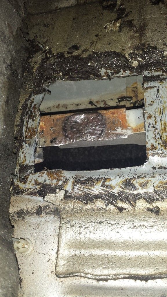

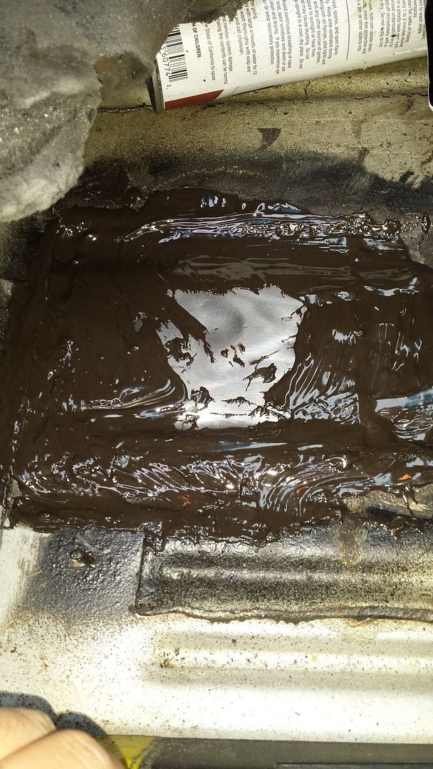

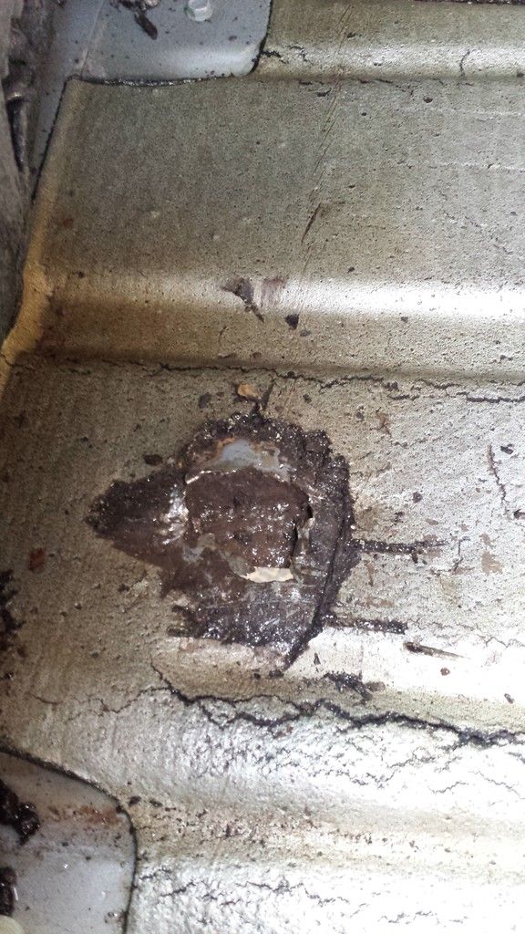

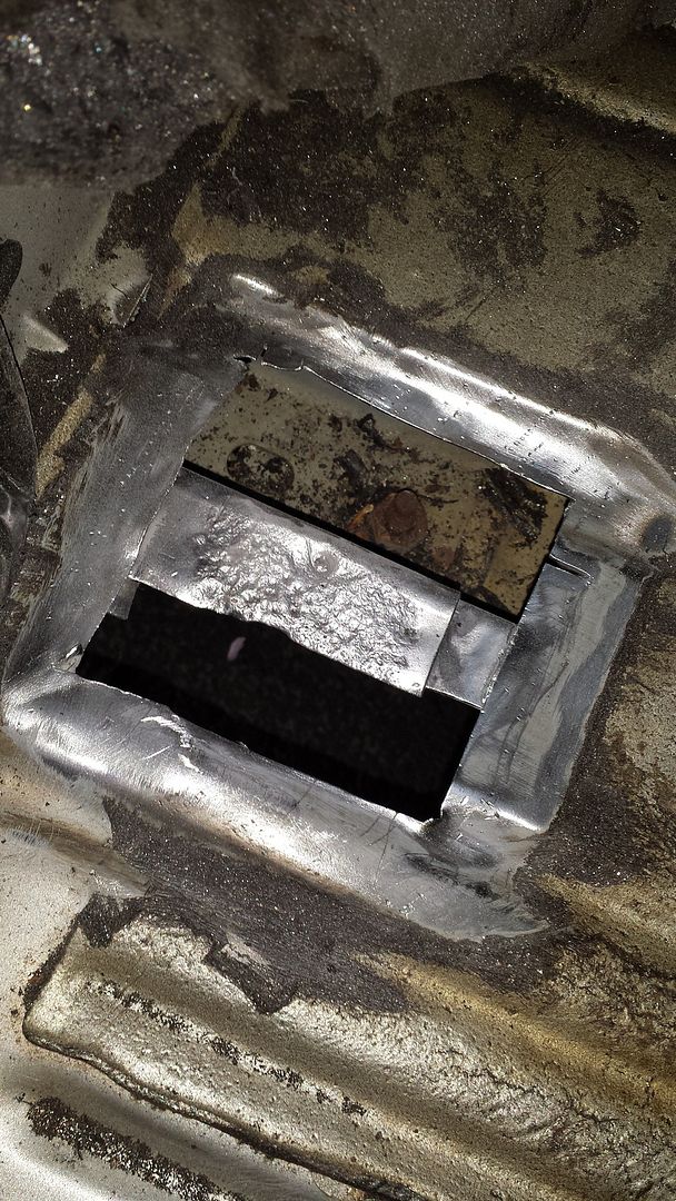

Hope you find it, because i didnt know i had a door leak, i had like an inch of water on the passenger side floor board but it didnt smell nor get the carpet wet thanks to the plastic glued on the carpet.. And it ate a hole and pitted my frame in my rust free 5.9, had to cut, clean the metal and weld a new peice of metal in there and then jb weld it and paint and undercoat it..
