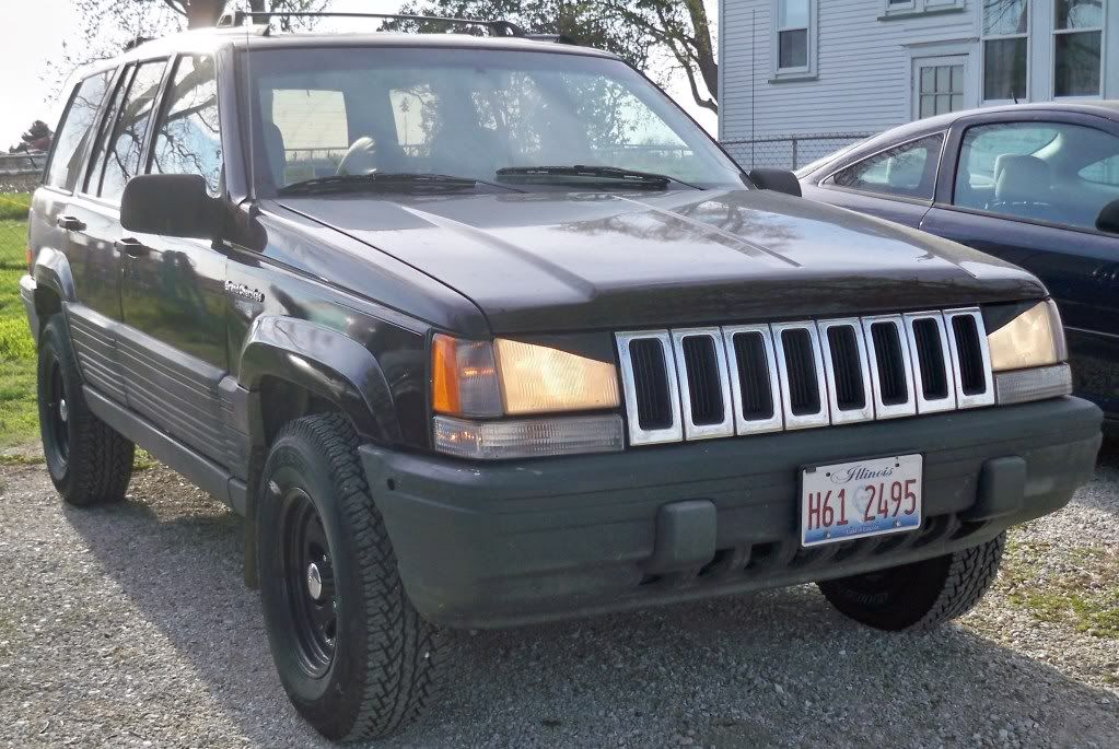

I have a 1993 zj with a 4.0l and I've had the jeep for about a year and a half. Ever since I bought it , it has done this sputtering and hesitating. I've done alot of searching around the Internet about my problem and can't find what the problem. I cleaned my throttle body out perfecty and the problem got a little better but it's still not perfect. I don't know what else to do?! Help?!

Seafoam the engine. $5
Plugs, wires, brass cap n rotor. $50
MSD Ignition Coil $50
NGK (not Bosch) O2 sensors $50
Hi-flow cat $90

i did do seafoam and nothing worked. it has a new distributor i put in it. new wires. new plugs. but i havnt tried the O2 sensors. and i do not have a cat on it.

Does it always hesitate and sputter? Every time? Does it hesitate and sputter when its cold engine or hot engine?
Do you have a Check Engine Light on?
Have you ever had the fuel pressure checked?
Does it have shifting problems? Jerking or bucking as you accelerate?
Does it ever just shut off on you?
every time yes
hot and cold
never checked the fuel pressure
check engine light not on
shifts fine
never shuts off

My 95 ZJ had a simular problem until I replaced the TPS. I removed the TPS and tested it. It had dead spots. Installed a new one and it ran great.
