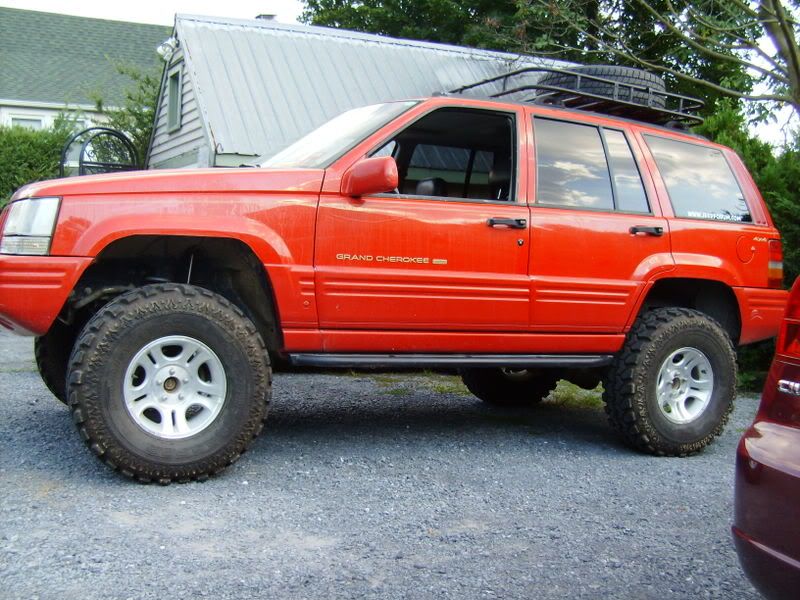

Here's some fender trimming.

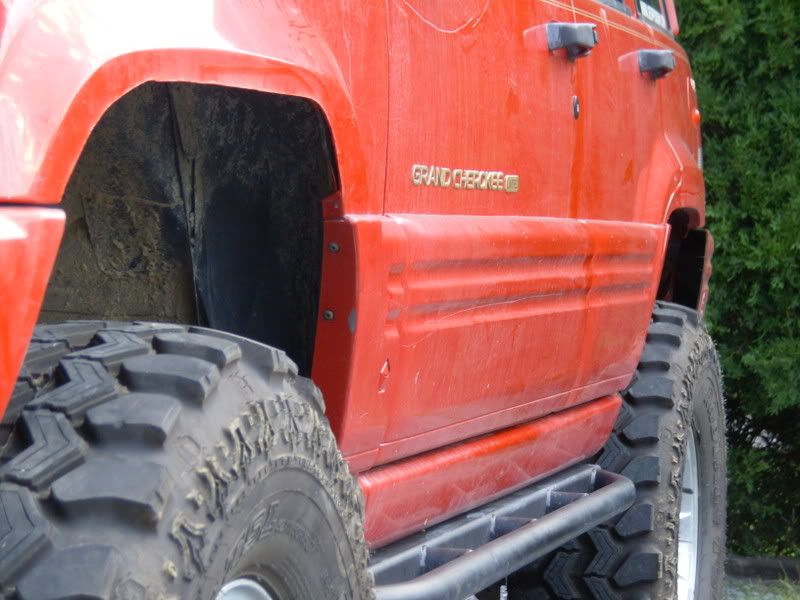

This pic is closer. You can tell where I took the front siding off and how I used a 5lb sledge to massage the front pinch seam flat and where I cut the ARB forward another 2 inches.

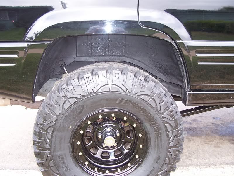

More trimming front and rear.
mine are trimmed just like yours. http://s159.photobucket.com/albums/t...med%20fenders/

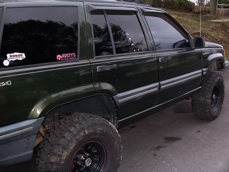

A little more off the front and then do the rear
04TJ 4.0 rc 4" susp lift, jks 1.25" bl, 1" front spacers, brown dog mml, aa sye, tw ds, 35" mtrs, rock crawler front bumper, barnes 4x4 rear bumper and tire carrier, ar wheels, 8.8 with lockright, jeeperman sliders, warn m8000, jks quicker discos
95ZJ 4.0 rusty's 3" susp lift, 2" front spacers, 33" mtrs, addcos front and rear, black diamond front track bar, jks rear track bar, jks quicker discos, trimmed fenders
