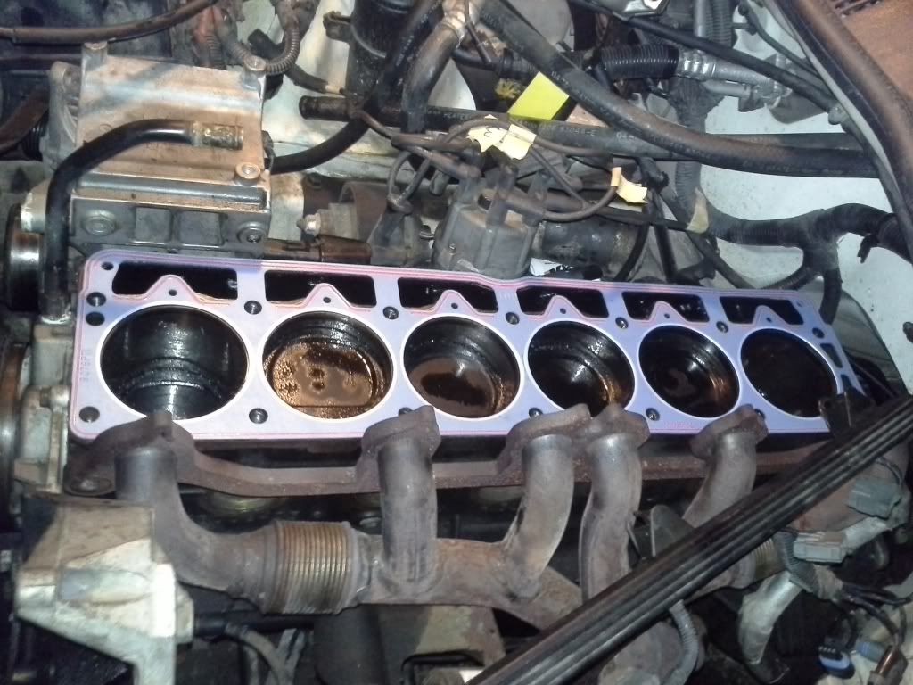

Primed oil pump and bolted her in.
A little dish soap and the seal slid in with minimal frustration :-)
I've got everything sealed, bolted and torqued. I'm just waiting to pick up the head from the miller.

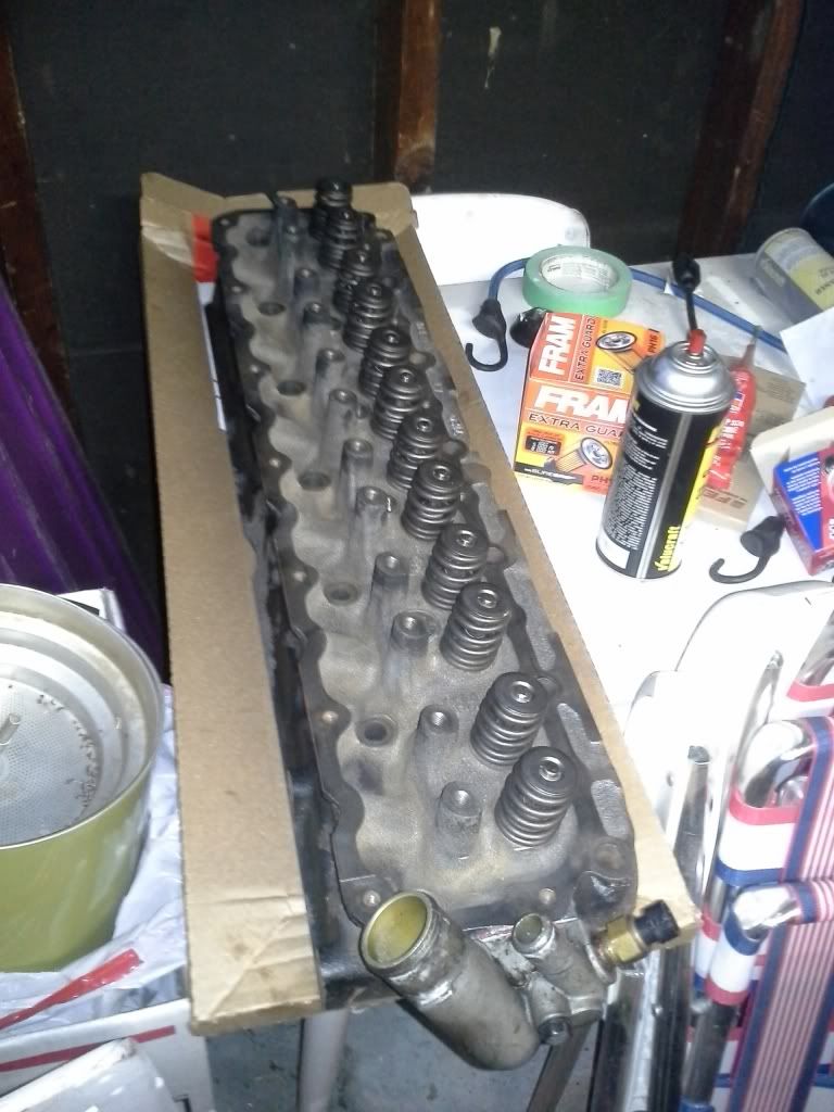

Got the head back yesterday. No cracks and no leaky valves :-) Looks pretty damn good. Cost 95$.
Just waiting on a second set of hands to set her in.

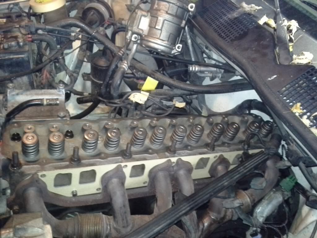

Got the head on, bolts greased and torqued. Should be finished tomorrow :-)
