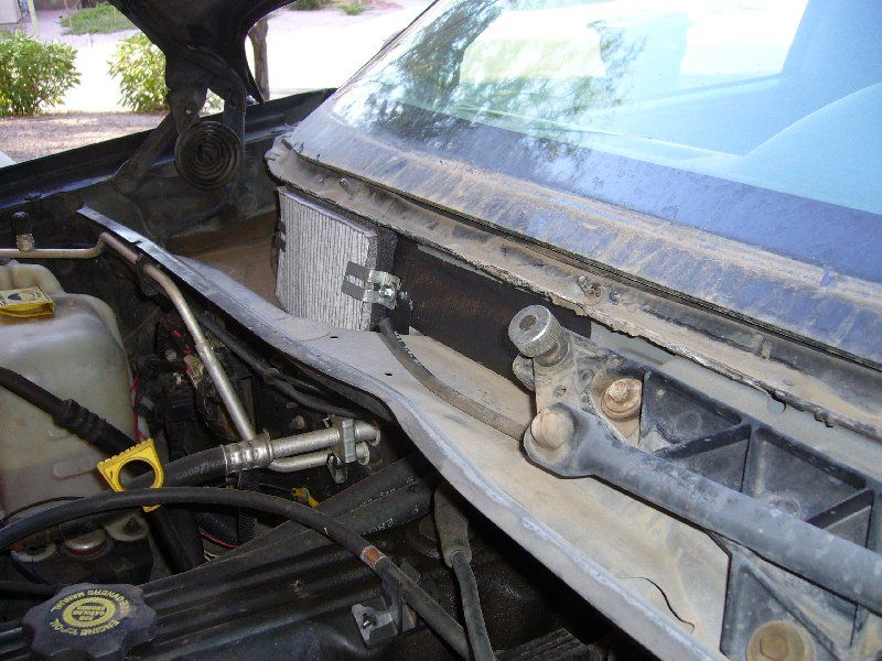

I've looked at write ups on here for creating a cabin filter for the ZJ. One was more work that I wanted to put into it and the other was almost perfect except I wanted to use some type of filter with Charcoal in it. This is because sometimes even with the vent on recirculate I still get the smell of exhaust from my slightly cracked exhaust manifold. That's because after so many years the little bit of foam around the vent doors in the AC compartment lose their ability to seal and you still get outside air whether you want it or not. I found some part numbers for the Fresh Breeze filters that I thought might work really well because they looked like they stretched over all 3 vent openings in the cowl but when I got to the auto parts store they only had 3 of the filters in the whole place. Figures. So I got the one that looked like I could use. That part # is CF8921A.
When I got home I put the filter up against the two main air intakes that are behind the plastic screen in the cowl and found that the height was perfect but the width was just a hair too narrow so I put a strip of duct tape on each side of the those intakes overhanging just enough so when I put the filter up against it there will be no leaks. I also covered the small 3rd intake with duct tape completely since I didn't think that would kill the air flow too much.
Then I made a couple of brackets to put on each side of the filter and made new holes slightly higher than the existing ones that are there to help hold the top more securely since there's a curve horizontally as well as vertically on the ZJ. The curve doesn't allow a flat seal. Then I just screwed two screws in and tried it out.
This filter has foam around the outside of it and it makes a very tight seal on the top and bottom. As far as the sides it seems to seal pretty well there too. You can see that I bent the brackets in just a little too far and kinda pushed the filter in a little on each side but it does seal really well. I haven't tried it out yet to see how well it filters outside fumes but I will do that tonight or tomorrow and post my results.

That area is where water drains when it rains and what not. If the filter gets wet it will be a great place for mold to grow. The filters I have seen on the newer vehicles are in the dash. Usually behind the glove box area.

..or the drainage is done in a place so that the air filter won't get wet. I've had a cabin air filter on a couple of my vehicles, all have been located in the cowl area for easy access/ replacement, but they've had a sort of a small sink and a drain at the bottom of it in front of the filter, so that it should never get wet.
I've been tossing around the idea on how to do a functioning cabin air intake filter, the plastic mesh is a joke. Driving in winter roads in all the dust the cabin and windshield gets dirty way too quickly.

If anything I would cram a piece of foam in there and remove it often to rinse it out.

Drill a large enough hole in front of the filter at the bottom of the recess, use gasket sealer + piece of tube to route the water out of that area abnd out to the wheel well. Problem solved
