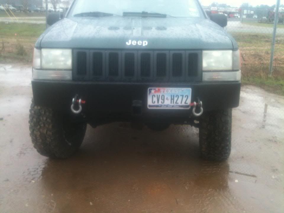

Search for the knockoff CAD blueprints floating around out there. Sketch up or something? Its a good design of a front zj bumper, with all the pieces you need to cut out.
Other than that, heres mine.
Front is an rlc.
Rear is a kevins knockoff.
And a naked zj front end. See the two oval holes in the sheet metal below the grille? Most (if not all) hd bumpers mount into those, and sandwhich the outer frame rail. If you have tow hooks, look at how they mount.

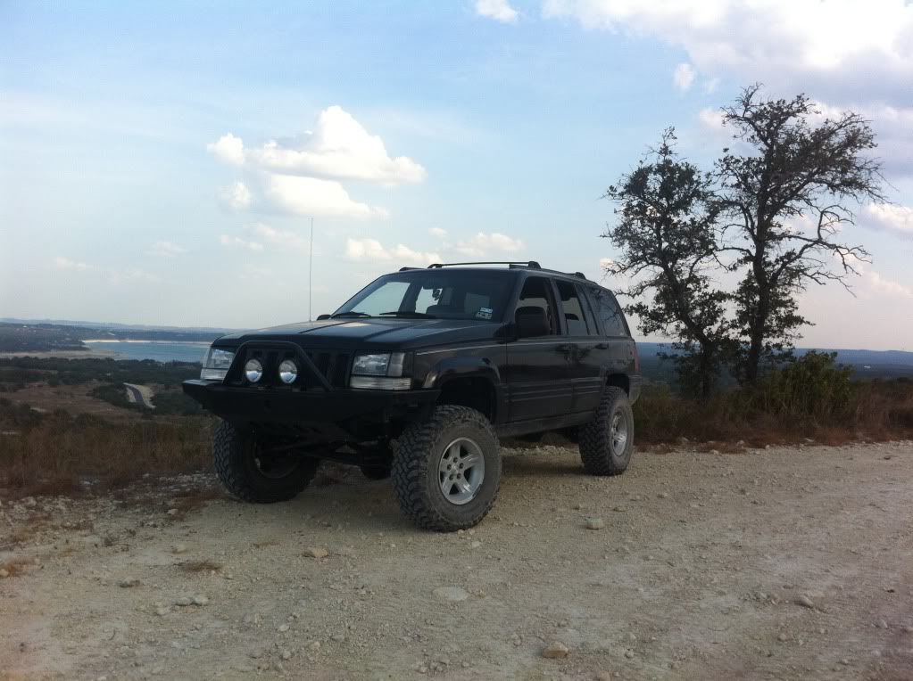

Here are the bumpers i designed and made.
let me know if you'd like more pics during the build
Did you ever throw them on the scale? I am curious how much they weigh.
im not sure but now im curious! ill have to buy a scale tomorrow

Mine weights right in at 85#, all 1/4" plate
