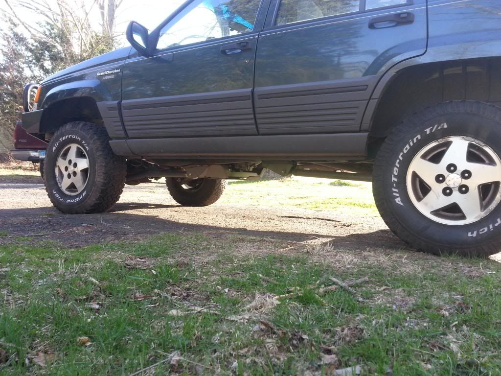

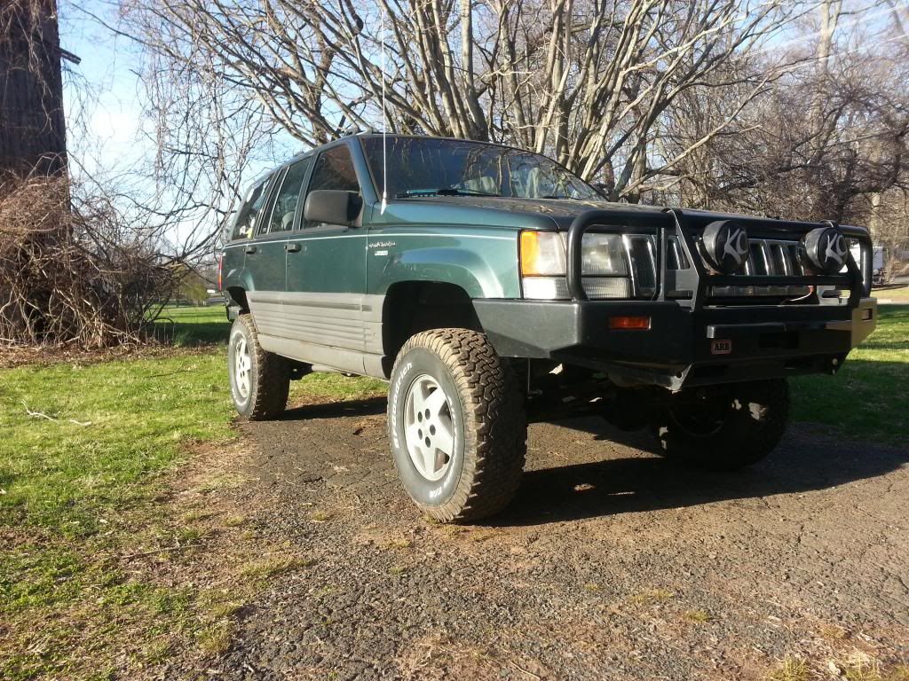

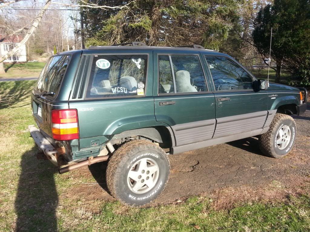

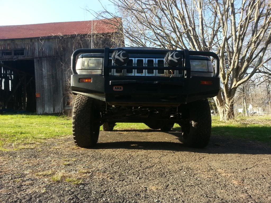

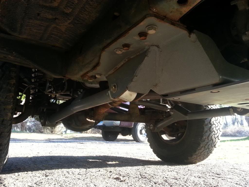

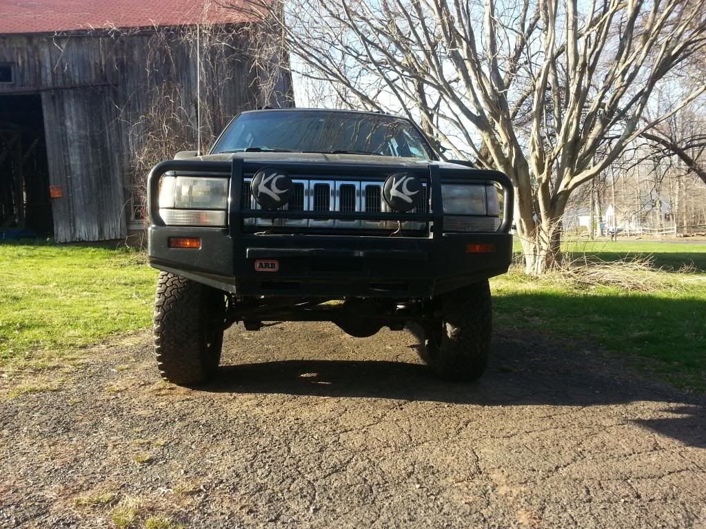

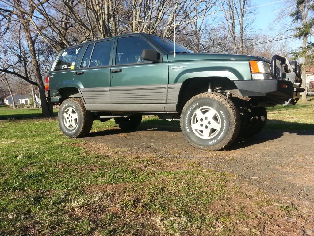

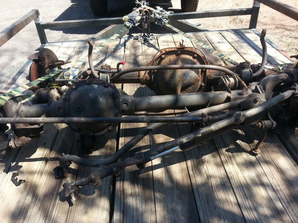

Originally Posted by chadcmb View Post
this thread needs pics!
indeed it's been far too long since I visited this thread or this project but now it looks like this project is moving again and for inspiration I snapped some pics of how she sits right now...
Oh and I picked her up some goodies on the way home the other day...
ckzj is offline

8.8 and an hp30? Nice

'95 XJ hp-D30 - I am going to be rebuilding completly and throwing 4.88's in it. I hate to invest too much into it but not sure what to do about traction device and shafts. I want an ox locker but really not wise to drop big bux on the D30 i think. Although my plan is for 35's, no bigger really
'00 8.8 exploder axle complete rebuild with 4.88 gears, the ultimate 88 kit is also gonna happen, just not sure what kind of traction device to go with here the ox seems justified and worthy. The device needs decent street manners if possible, that basically means selectable or LSD... I learned about the Super and Ultimate kits out there, the yukon kit looks like it's the winner unless I hear to stay away.
monte heck of a lead on those cables thanks! I dont have much like that lying around
Also got 1.75" pucks and replacement OEM isolators in the mail so total of abut 6" f lift is planned.
