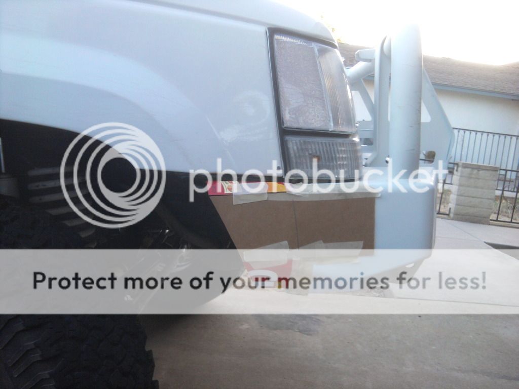

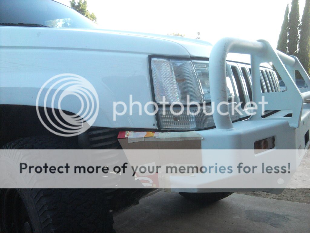

alright i made a rough cutout of what i am thinking of doing. thoughts comments concerns?
before: (the good side)
what i am thinking of doing (the main section there would be at the pencil line not that whole thing.)
