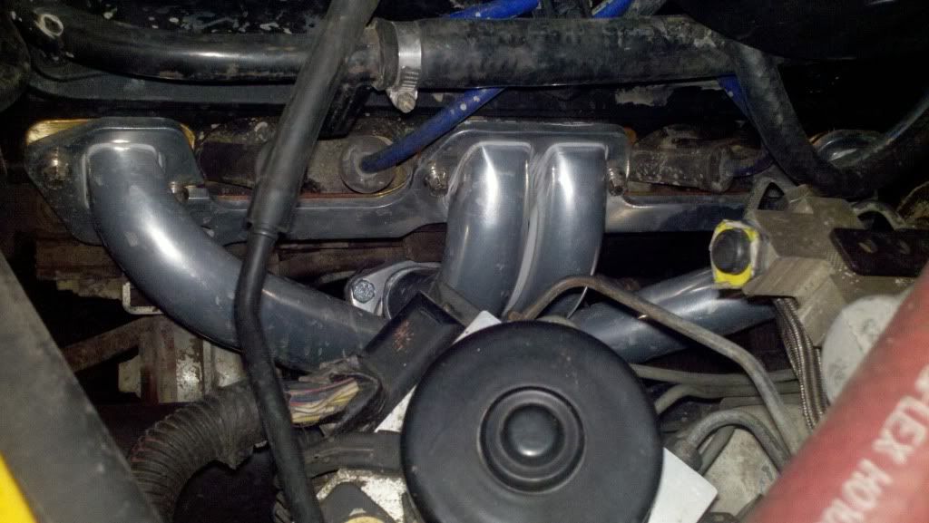

Posts: 19,822
The bolt pattern is the same.
Newer headers appear to have the large magnum ports. The summit ones I just installed do. The old la manifolds have different shaped and smaller ports.

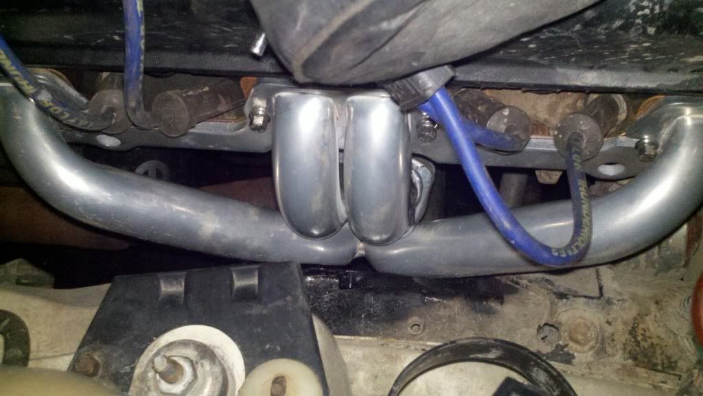

Posts: 19,822
There is a hump on the frame on the passenger side that needs notched to fit them.
I'll get a picture.

'97 zj 5.2, some stuff, some other suff, and some things that even work sometimes.

Posts: 206
That's hot
