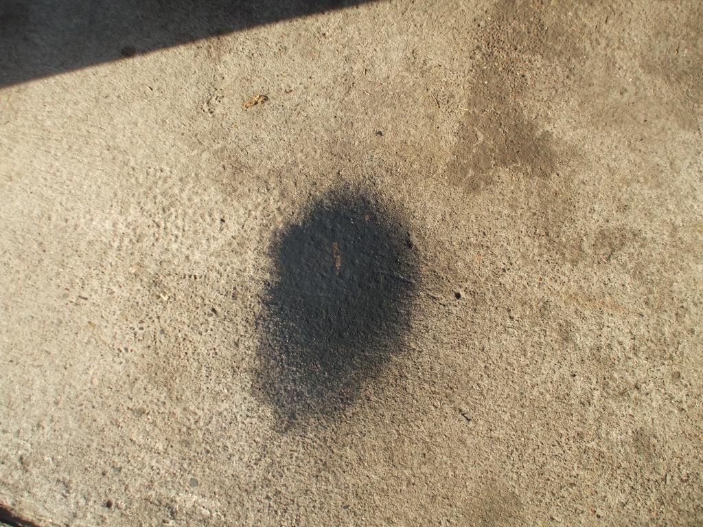

when it runs rough and you see this 10 inch circle of burnt crap from the tail pipe
hmmmmmm , plenum or rings ?

I wouldn't say it's the plenum, my ram has a blown plenum and I only see it smoke at start up. It's never ran rough. Get a compression test on it.

Could just be a bunch of carbon buildup. If you don't beat on the motor much, take it out for a good, long drive (20 - 30 miles) and once it's good and warm, beat on it a bit (some WOT pulls from 40 - 70 would do it). That should clean it out a bit. However, if it's carboning up badly, it could point to a bad plenum. How much oil does it use?
it has a ... personality
it can use a qt or two between changes
i did an italian tune up today and a few wot pulls in the yard to loosen it up
it shook some before i changed the oil a few days ago but stopped for a few days then yesterday and today its been running rough again
it hasnt seen hiway miles for a few weeks i think im gonna put some seafoam in the tank and see what it does
97 zj orvis/04 wj ltd/02 lancer oz rally/85 rx7 gs
How long do you go between changes?

2-3 months

I meant number of miles, as that'll give a better idea of how significant the oil consumption actually is.

2,-3k or when it looks dark
and i use valvoline max life 5w-30 in the winter
i notice it usually needs some oil after high speeds ( 70+ )

That's definitely a good bit of consumption then. I go through about a 1/4 - 1/2 quart in 6k between changes. Running it harder definitely goes through more, especially in hot weather. A good bit of mine goes through the PCV though (I've got a catch can on it and I end up with a good bit in there if I beat on it during the summer).
Definitely check out your PCV, etc. When my plenum started to go (just a small leak), I was burning a quart in 3 - 4k miles, which dropped dramatically after doing the plenum.
