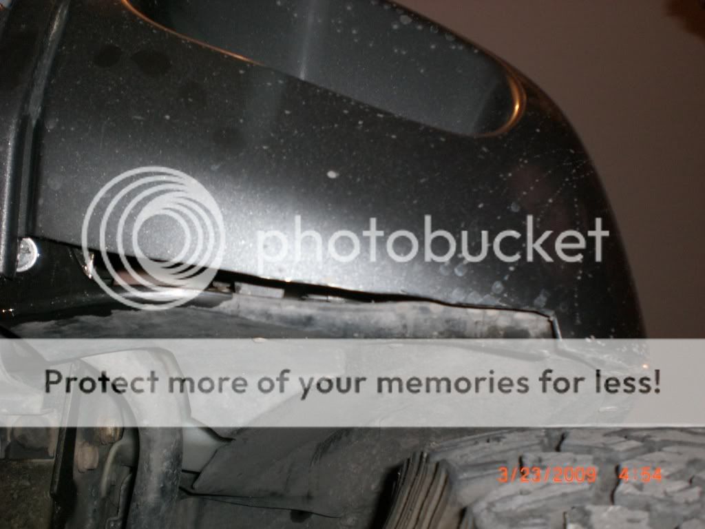

you can run stock shocks?
I ran mine and did just great...
the tires will be ok but is recommended you use spacers if you run 31s or bigger!!!
i ran 265/70/17(32s) and didnt use spacers it rubbed a little bit but wasnt noticable at all to me!!!
i did need some trimming on the front bumper cover and proper bump stops
this was all the trimming i did!!!
not bad for 32s huh!!!
good lucl to you guys with future BB mods I just sold mine too thought i had to move up haha!! B was fun tho never had problems and install only tool about an hour fly solo!!!
