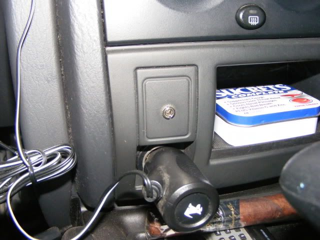

I bought a jack that went from the RCAs to a 3.5mm female wall mount. I then drilled a hole in the little plastic piece below the radio and mounted the jack there. Then I just got a short double male 3.5mm cord and run that to my sirius or ipod. I'll go snap a picture.
EDIT: Here are a few pics and the parts I used.
RCA to 3.5mm wall jack
3.5mm stereo cable
And pics...
Good lord is my Jeep filthy. Deer season puts a hurting on my interior.

This is the exact process I was considering before I thought about running cords all the way into the cab. I really wanted to put that female panel mount 3.5mm jack exactly where you put yours. Was it difficult to get behind where you put the jack? How did you run the wire to there from the adapter/back of radio?

Although I don't remember exactly, I do know there is a clear path to run the wire from the back of the radio down to that location. I didn't have much of a problem doing it. I don't think I had more than a half hour or hour in the whole process. I'm pretty sure there are detailed instruction on wjjeeps.com on how to pull everything apart.

Perfect. Thanks for posting pics. One last question, were you able to find that panel mount Female 3.5mm to RCA cable anywhere else for less than the $29.99 that site has it listed for? I remember doing a quick web search and not finding one, but didn't look too hard.

I looked on the web and only found it from data pro. You Definitely don't need the 10' one which is 29.99. I'm pretty sure I got the 6', but I'd think the 3' would probably fit too, but for $2 difference I just went with the 6'
