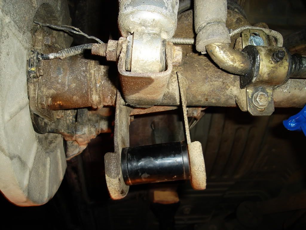

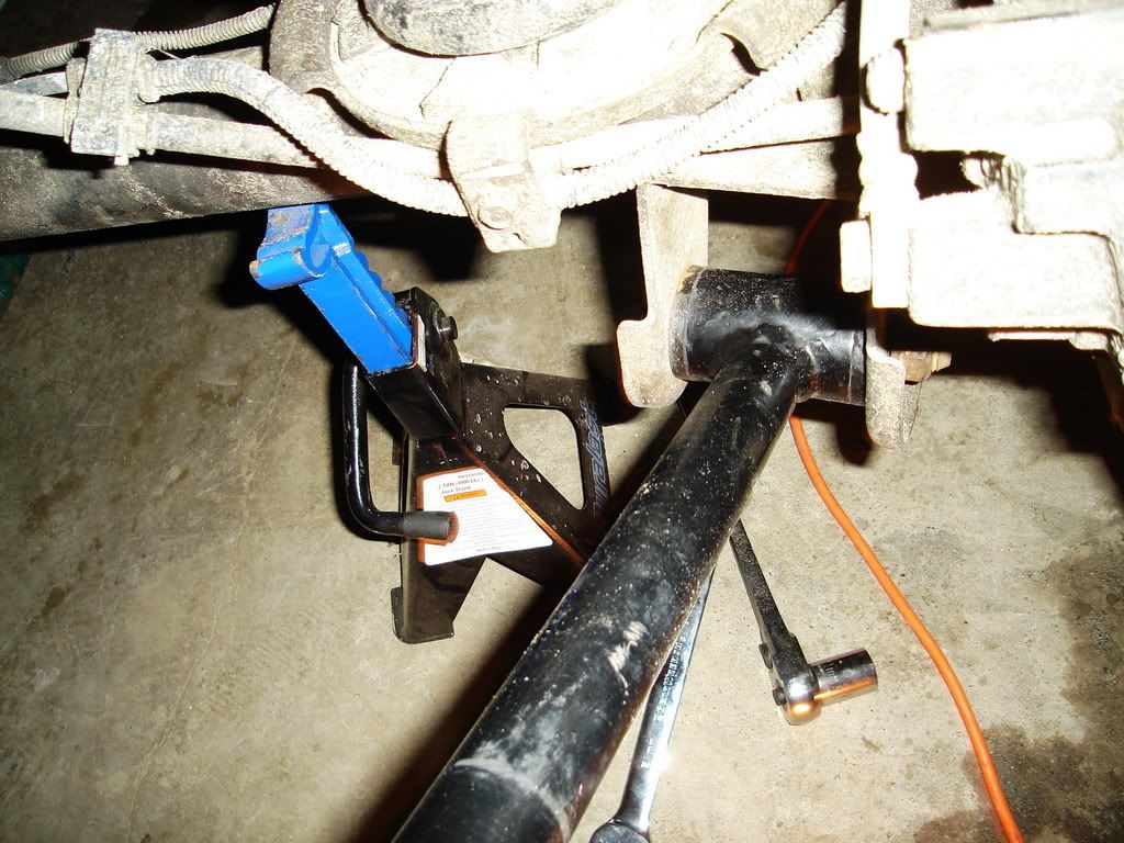

Pics of how I mounted them - looks right o me
The tera directions basically only said that the zerk should be facing up, so I did that. I also made it so the bend is further down on the axle side, I'm not sure if that matter...
Greasing them I'm pretty sure all I have to do is the zerk right ?
right
no grease for bushings

You may need to use some 1/2" washers to shim the body side mount.
