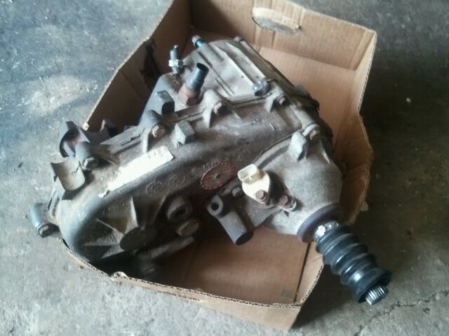

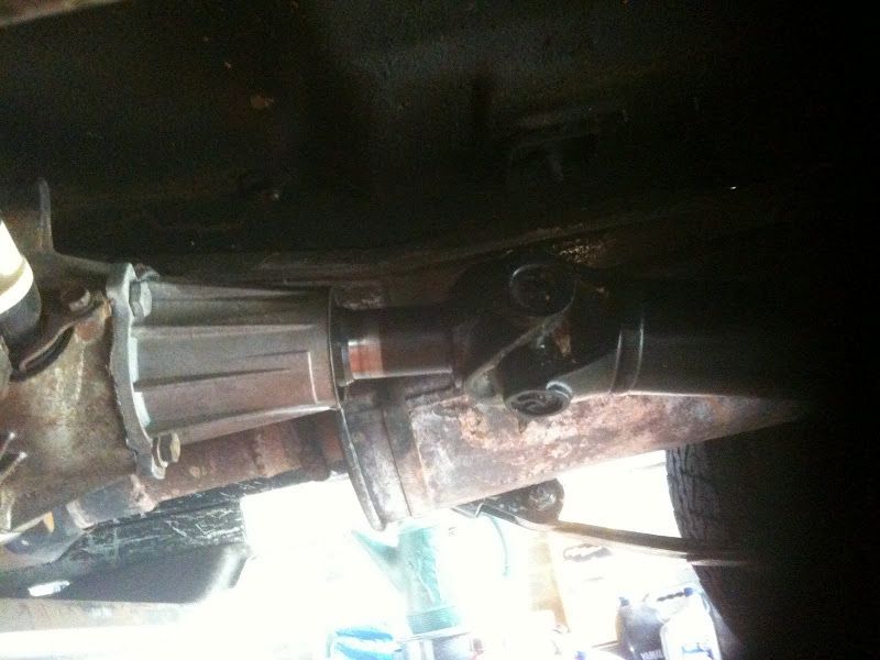

mid 94 was when they changed gear cuts. you will want an internal slip yoke 242 if you dont want to mess with the rear driveshaft. IIRC most 242s before 1995 had the internal yoke. its easy to tell them apart
^external
^internal (the one you want)

If you get a 242 from an older XJ (pre-95?) you'll need to swap the input gear, tailshaft is same internal slip yoke.
The VIC gear switch on them is 2-contact, different to one on 249 case and it's not possible to swap them
cause they are different length and located in different locations.
If you get a 242 from a newer XJ, input gear and switch connectors are same, but for external slip yoke
you'd need a driveshaft from a ZJ with an ESY 242 case. Pretty hard to find.
Or just cut up your 242's output shaft to same length as 249 was and re-use the original tail shaft,
just add a rubber boot for splines from any ESY XJ tailshaft.
They're pretty much the same, ESY and ISY tailshafts, just different length.
