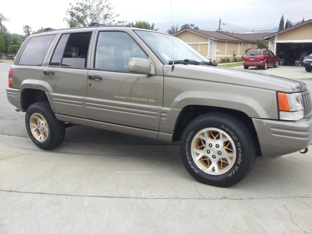

hey all, i just picked up a 98 grand with the 5.2L and am lovin it. the jeep is going to get a 231 with SYE in the next week or so, that leads me to the question for the experts: if you had an $800 budget, what lift would you spend your money on? this is my new DD and trail rig, i like mud and climbing rutted hills, any recommendations? i intentionally did not throw out any lifts, thanks.
thanks for your time
here is my rig
im giving my old girl a break from off road duty
