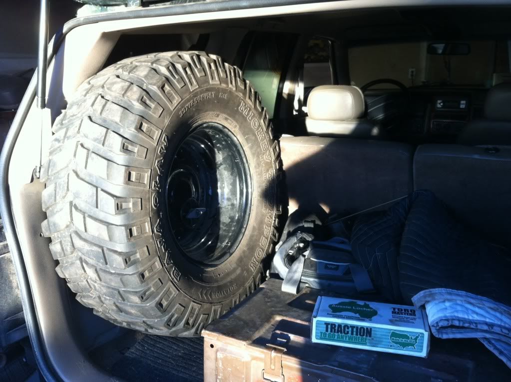

Here's my set up. It takes up a lot of room

Johnny,
"traction to go anywhere? Anywhere?" That thing is amazing.

shhhhh!!!
thats my secret weapon...... an aussie locker in a box!
don't you know, that if you carry it around with you the lunchbox locker fairies will magically lock the front end for you? forgot to take the locker box out of the jeep from when i intalled it. been that long since i've driven it.
frankly when my jeep makes it out of the garage i'm impressed.

Wow look how artistic and dramatic Johnny's picture is Great use of the lights and darks. Let this be a lesson to you all. He has set the bar.
