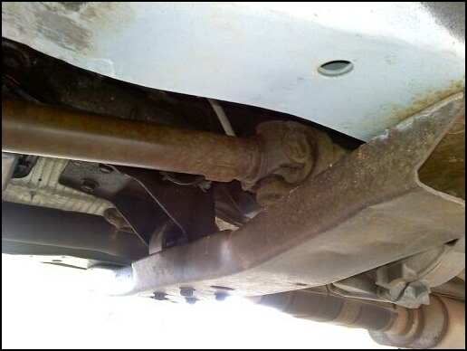

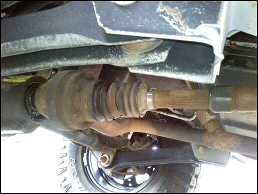

Hey guys I have searched and haven found much but can someone just identify my front driveshaft? Also I need to get it rebuilt I think it is making some pretty bad noises at the u joint by the TC...I have a 3.5" lift do I need a different driveshaft due to the lift? Also my jeep is the 1996 with the 249 is it safe to pull the drive shaft out and run for awhile while I get this one fixed or get a new one? I hear its ok in a 96-98 but not 93-95. Thanks!

Might as well pull the front DS. It's a CV style which is not ideal with any lift. Looks like you have a leaky pinion seal as well. You can get a u-joint conversion that has a CV style flange so you don't even have to switch yokes. Or you can swap out yokes and go to a full double cardan with all u-joints.

If you want a technical term for the shaft... It's a Double Cardan Rezeppa

WOW. Bad pinion seal, bad cv joint, and bad double cardan. Probably be cheaper to buy a new shaft.
Replacing the pinion seal and take requires setting the pinion rotating torque again, it well take a minimum of 175ftlbs on the but and you need to measure rotating torque with a 0-60inlb beam or dial torque wrench. Measure initial rotating torque before you pull the nut(you need to remove the axle internals first), add 5inlbs when reassembled.
You can buy the drive shaft cv joint and replace it yourself easily though. The double cardan is more frustrating.
