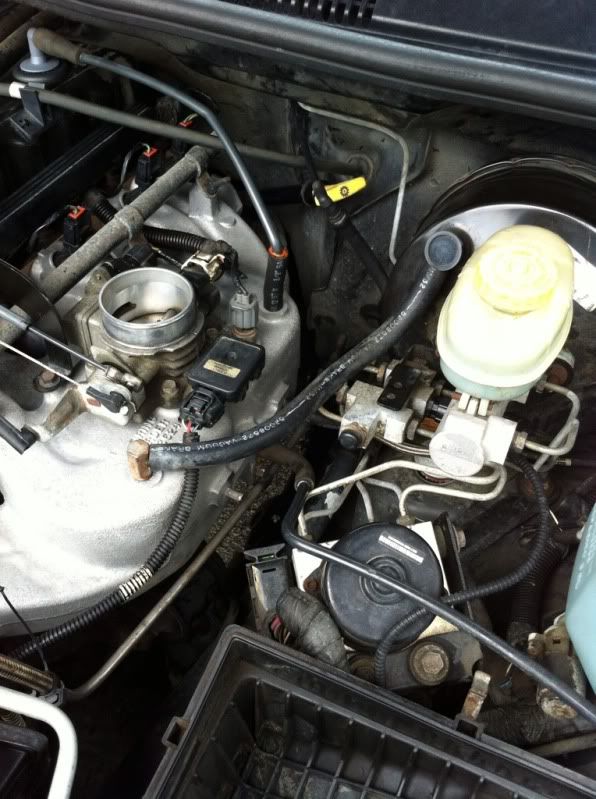

post #14187 of 46668 Old 07-23-2012, 10:37 PM
torchd
2003 WJ
Location: Chicago
Posts: 2,855
Who here has done the WJ intake upgrade on their ZJ?
On the stock ZJ intake all ports were used except for 1 as well. Mine had a black plug when I bought it. That's why I have one of the ports plugged with the WJ intake. I am not utilizing all the ports.
Ok here is a shot as my intake sits now WITHOUT the blue cap on the open port. If I put the blue cap on, I am back to where I was. No crusie control and the air only comes out the defrost.
If I take the blue cap off, I have crusie control and my air works on all settings. Then I have a vacuum leak..... LOL
from my thread here.. http://www.jeepforum.com/forum/f13/i...ctors-1396015/
