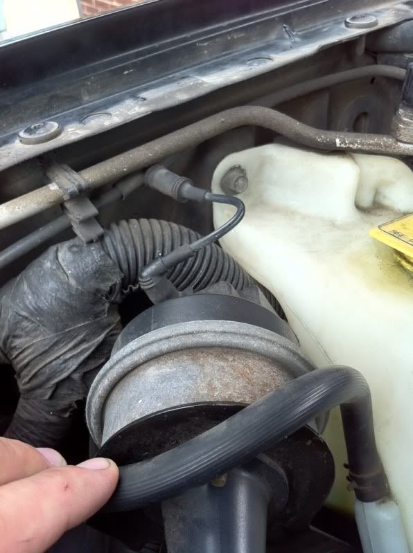

Your first picture, I didn't even touch that vacuum line where it goes into the Jeep. I inspected the line, there's now cracks there at all.
Also I looked at my cruise control vacuum line, which looks like your vacuum line in the first pic, again I didn't even touch that line and it looks good.
All lines are in good shape, show no signs of cracks. I will go out side and take some pics

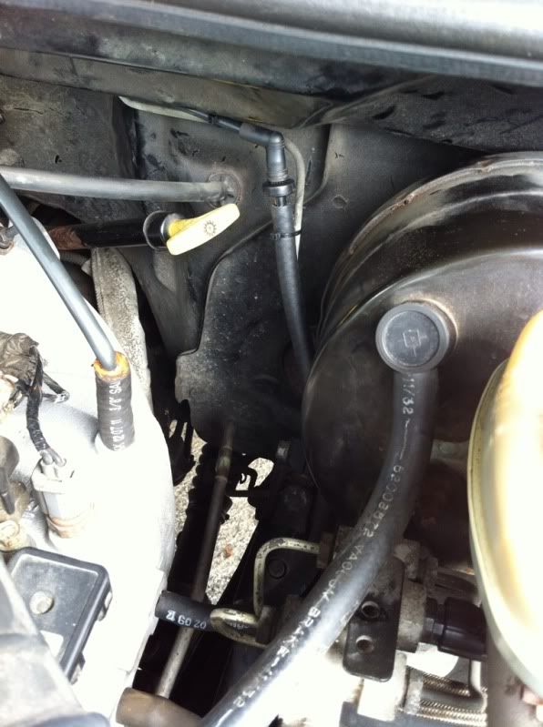

First Pic - Vacuum line for cruise control
Second Pic - Vacuum line for HVAC

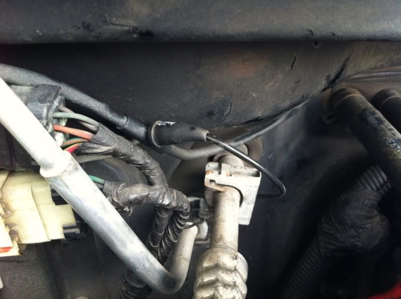

Third Pic - Same vaccum line for HVAC where I had to re-locate it on the side of the intake

Well I took my battery and battery try out, traced the vaccum line that goes to the black vacuum box and everything was fine there.
I connected everything back up, grabbed my break cleaner and started spraying the vacuum lines with no changes in the idle of the motor.
Where is my vaccum leak? Maybe an intake leak? My jeep idles perfectly though so I am confused

With the Jeep running, I unplugged both cruise control vac lines (pic 1) and you can hear the vacuum sucking.
I then unplugged the HVAC vac line (pic 2) and again you can hear the vacuum sucking.
I then pulled the new hose coming from the side of the intake (pic 3) and once again you can hear the sucking. So I then made sure I installed the check correctly
