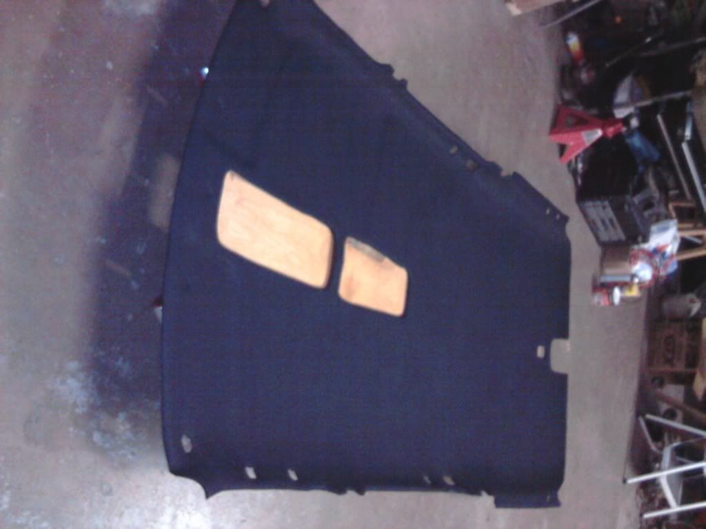

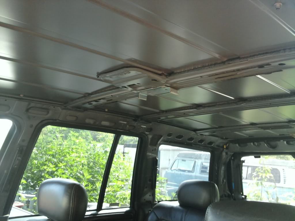

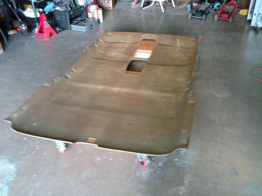

5.9 HEADLINER TIME... got a Jo-Ann's flyer with 50% off coupons in the Sunday paper so getting it done for under $50. Second one for me as I did the 4.0 several years back - and to think they don't stock the red headliner fabric anymore!!! Anyway, if anyone's interested in what is needed I'll explain below.
Remove headliner carefully. Ask a friend to help so you don't accidentally try to hold on to an edge and break it. They're pretty flimsy but can be handled/ removed in one piece if you are careful.
Once out, I easily peeled off the fabric from the fiberglass backer. Then I cleaned off the old foam with a tire cleaning bristle brush and vacuum cleaner. Worked like a champ and got it very clean.
I used two cans of Weldwood Contact Cement - one gel and one regular. I like the regular one better as it seems to spread easier, the gel seems to go too fast and cakes up in areas then doesn't want to spread - gel is even harder to spread on the foam backed fabric. I lined up the material (3 yards) and peeled back 2 ft at the front of the backer by the sun-visor crevices. With help form a friend, we splattered the cement on both sides using disposable brushes, then let dry for a few minutes and stuck it on. Careful here as one mistake or wrinkle is very hard to work back out. We took out time and repeated the process until the whole thing was covered. Finally I trimmed the edges off and glued 1 inch all the way around the back of the board for added anti-droop feature. Still need to install it but I let it cure overnight.
