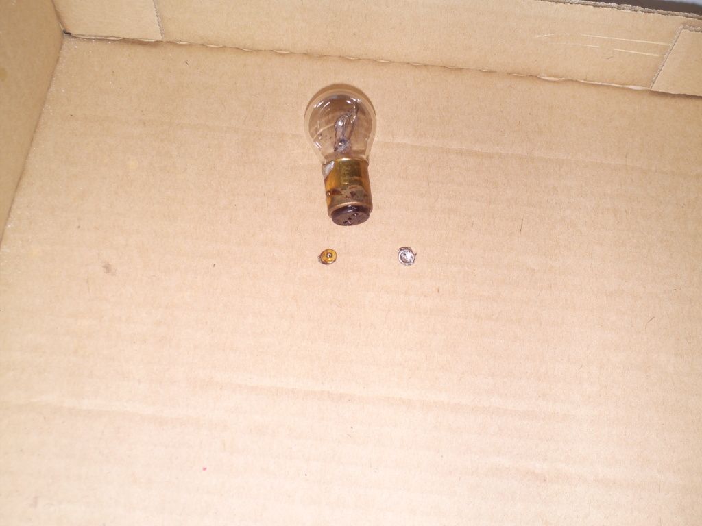

Took the niner for emmisions & state inspection it passed then went did one hella burnout went to fill it with gas wtf gas jumped from 3.07 to 3.25 then i was like **** i gotta run hightest in here 3.59
On the 94 i was pondering selling it then i got this rear lamp failure message well all 6 brake lights work and for some reason when i press the peddel the dash lights come on i cant win when it comes to electrical BS
Got one that dash lights wont go out now i got one that dash lights come on when ya hit the brakes
Gonna put a new brake switch in the 94 see if that fixes it
One of your dual-filiment bulbs in the rear tail light blew and the blown filiment (brake) has come to rest across the second filiment (park) inside the bulb. The brake filiment is finnding it's new "ground" thru your instrument panel. If the dash glows when you hit the brake, it's either the lh or rh brake/park bulb. If the dash were to flash with your blinkers, it would be either lh or rh turn/park bulb. With your 94, it's an 1157/2057 bulb.
going to go check that now

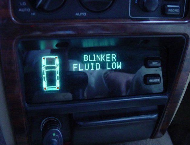

oh and this message?
Got it stuck. It's still stuck. It's so stuck I could call insurance and say it was stolen and no one would ever know. It's so stuck I don't know anyone with a capable enough 4x4 to even to to where I got stuck to winch or yank me out.
I owe you a beer
it was a the nipples slid and were touching, pulled a bulb out of the 93(that aint going no where any time soon ) one bulb split from the base the other worked out
now you figure this out i'll buy you a chicken dinner
