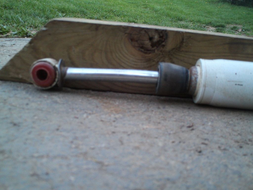

badbird how much up travel do you have on your rear shocks and how much lift is on bruiser? when I mount my tringulated rear shocks i'll have 3" of uptravel and am woundering if it will be enough. I would be running the same doeschtech 9000 as you if i had not folded them my last time out so now i got a set of 5125 belisteins

4.5 inch of shaft showing at ride height in the rear. Rear frame over the axle is 32 from the ground on 36s.

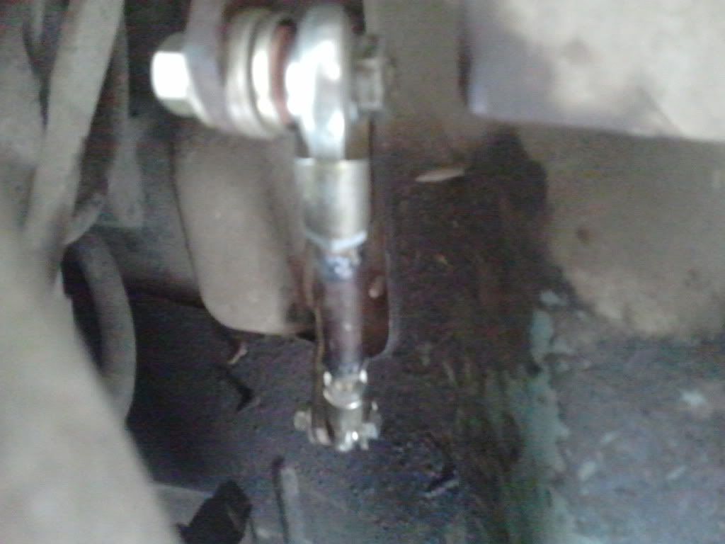

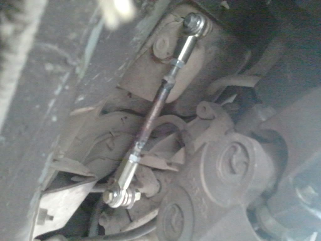

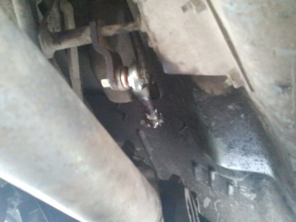

Made my own T case linkage, got sick of the old bushing crap. This one should last a bit... lol
