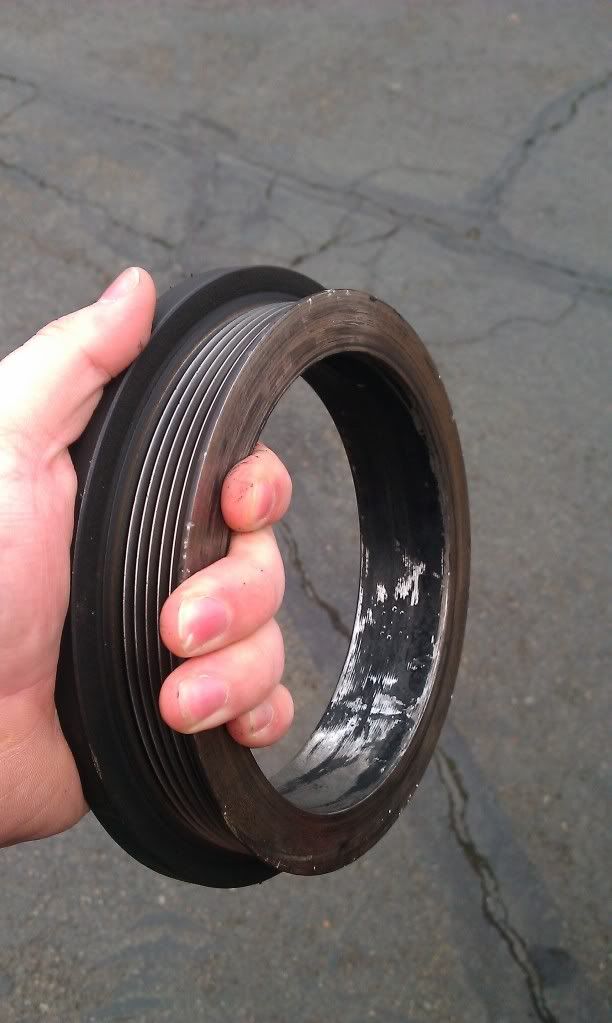

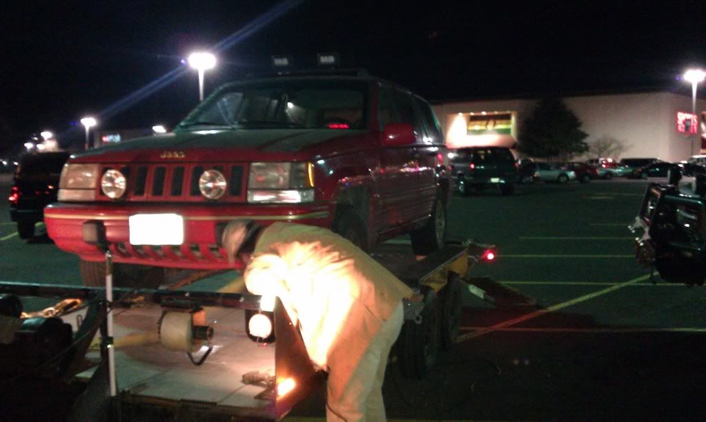

Here's the problem!

/\ that and as a result, this \/

Jesse--1. What the hell happened? 2. Are those Hella 500s on your bumper?

The crank pulley/vibration damper separated. APPARENTLY, it is all one unit GLUED together. At 177k miles, it came apart... the part cost me $57 and should be here....now. I don't work til 3 so I should have plenty of time.
