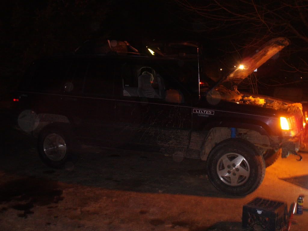

Installed a new valve cover gasket and rear CCV elbow on my 96 ZJ 4.0L. Sure wish the dealer would have had a new grommet in stock and had to use the old one. At least it wasn't very brittle or hard.
Couldn't get the rear elbow out which would have made getting the valve cover out a whole lot easier. Finally cut it off with a pair of bolt cutters but was careful not to get the pieces in the top of the cover or head.
Too cold out at 37 but used a hairdryer on installing the grommet and elbow so it went in easy. I did use a little silicone gasket sealer since it was leaking before and didn't have a new grommet.
I live in the woods and right at dusk the deer started running everywhere while the local fox started barking at me. Pretty neat as the full moon was coming up.
