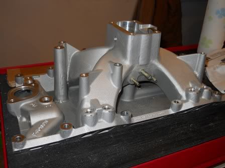

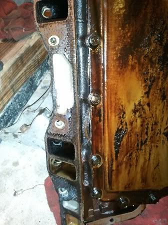

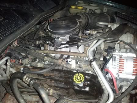

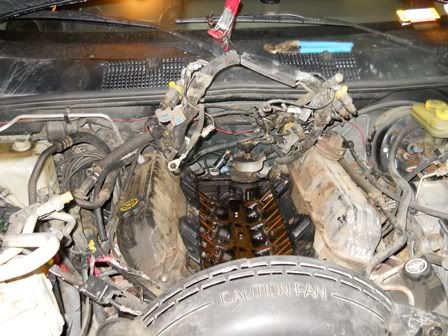

Blown 5.2 plenum gasket.
This weekend, I fixed this:
By putting this:
in here:
And ended up with this:
Semper Fi,
Extrememarine

Wow Wayne that looks great. I bet its gonna run a lot better. Now you need to clean the motor
How did the injectors work for ya?

Awesome, how's it run?

runs great.
it is clean - for a Jeep...
The injectors were a bust; one or 2 of them are bad (For everyone else - I had a set of Bosch 703 4 hole injectors to swap in I pulled at a junkyard). I need to make a test jig and test them. The initial start up was ugly - I think one of them was just pumping fuel constantly. I swapped out the 703's back to the original single hole injectors and all was good.
It runs tremendous now. The plenum gasket was blown in 2 spots. Detonation / spark knock is gone, throttle response is much crisper, it spins up through the RPM range much quicker, pulls hard from a stop. I had a weird idle surge / rpm hunt between 800-1100 rpms from the polished throttle body I put on; that is gone now; idle is steady and solid. I have about a solid 10 weeks of fuel mileage data from before the swap, and I'll track another 4-6 weeks to see how it compares. If MPG does not change, I'm still very happy because the drive ability is so much better.
I'm working on a write up for it - I found a couple things that might help others that worked well for me.
And a big thanks goes to Nick / Kolak for his help with this project. We must have exchanged 100 emails in conversation - he always was prompt and accurate with his responses. He's gained a repeat customer for sure.
Wayne
