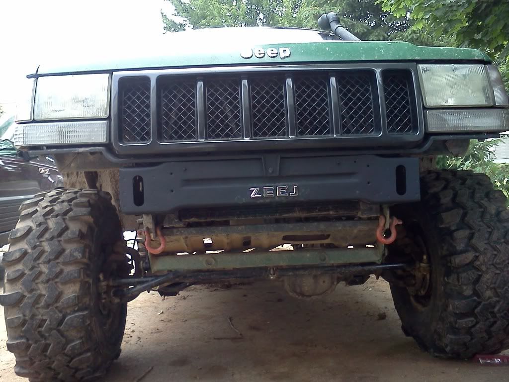

yeah it's rather useless on a lifted zj unless you ad a little more like this
What did you add? The slightly green piece of metal? And I heard they are usefull for somewhere to secure quick disconnects to.
2"square tube actually when i found the skid in the JY it was already welded on, it has saved my steering once or twice & yes thats where you can put the pins to secure the disconnects (which i have yet to do). make sure before you install that the threads in the "frame" are clean i have 3 broken bolts in the 94 i got to drill out now to be able to reinstall the skid they take the same bolts as the crossmember & radsupport so just pull a few extra at the yard and you can use them
