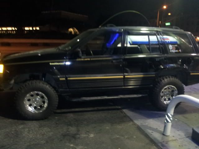

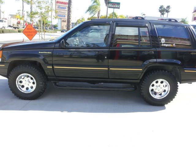

So I finshed my lift today and it looks great, but now I just have this erge to go taller and bigger. But here are some problems that Im having.
1-front wheels stick more left and the rear wheels stick out more right
2-rear wheels are not centered in wheel wel.
3-when driving in a stright line, my steering wheel is upside down
4-Jeep turns all the way left but not right.
5-Had to take out the mounting brackets and do some zip tieing to be able to drop all the way without no problems.
Hopeful an alignment should fix this all up right(except 5), if the guys know what their doing. Because I read other peoples threads and forums talking about this and ended up just doing it themselves and adj. the drag link.

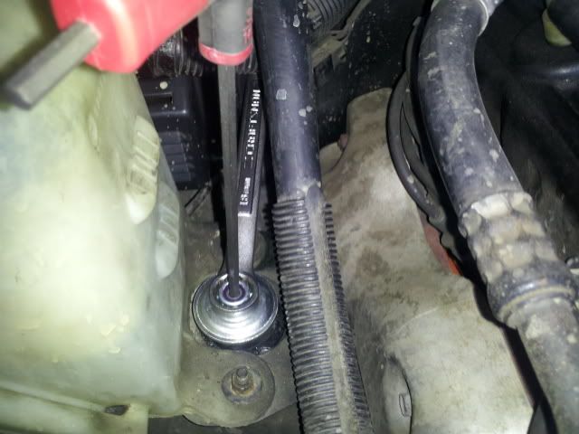

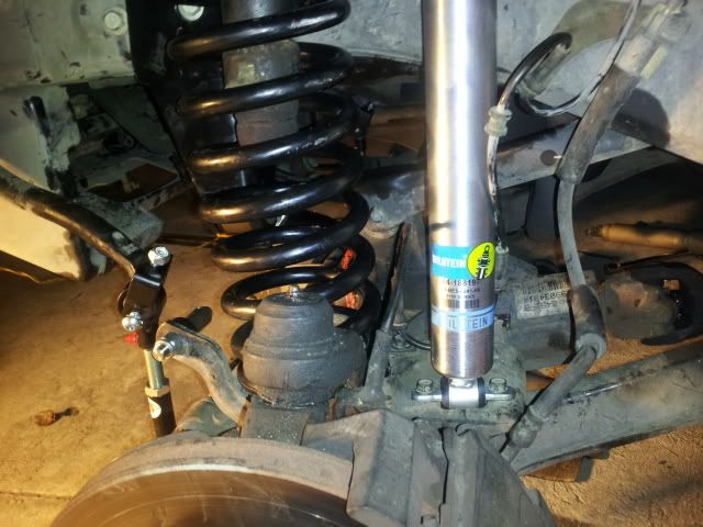

Also about the shocks, this is what I was talking about and how I tightend them.

omg track bars!

1&2 track bars
3&4 alignment

2 you can only fix with longer control arms.

1) track bar
2) control arms
3 and 4) alignment

Both upper and lower, would this be a fix it now before hitting the trail because it will rub the lower portion of the fender or can it wait?

It can wait. Tires move back as they move up. You could do the alignment yourself by measuring fnr of the front tires. Though I would start by adjusting the arm off the pitman arm to get it turning equal, and steering wheel correct.
