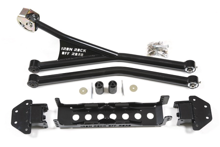

is this the IRO front you were talking about. Is this what is known as a 3 link setup. How would you say this works compared to a 4 link, or 2 radius arms...

Yes, it basically makes it a radius arm. I don't know of a true 4 link long arm front. Many of the 4 link rears are a radius arm as well, they just have 4 arms hooking everything to one point.

Those iro arms are radius one side, but still a radius setup. A true 3 link (+panhard of course) will have the bottom links like the iro and the upper link will go back to the crossmember/frame and not to the lower. A few xj guys run 4 links +panhard on the front
If you have access to tools and shop or someone to build stuff a true 3 link is the way to go

That's all a big debate. Minus pan hard bar if you have a 4 link that mounts to 4 seperate locations, then you will have better caster through the travel, but will have pinion angle problems.
My rustys has 4 arms plus pan-hard bar, but the uppers and lowers mount to the same bolt on each side, so it is a radius arm. If the uppers where mounted higher than the lowers, like stock, then it would be a true 4 link, but mine isn't. I'm converting mine to be a triangulated 4 link, but the arms are going to mount in the same location so it will still be a radius arm, and keep my pinion angle correct, but I won't need a panhard bar.
To each their own but for any type of use, I would prefer the radius setup, simply for the pinion angle. If your axle is sweeping 10-12 inches on bumps, constantly, I would want it to follow the driveshaft, especially at high speeds.
