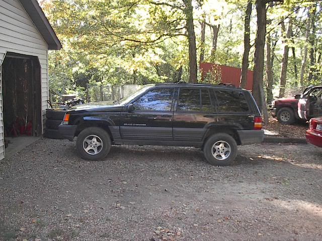

showing the progress
stock
after the 3.5 inch IRO lift
3.5 inch IRO lift and 32x11.5 Mastercraft Courser M/T's
we are getting a little rub on the right front corner of the bumper, figured we expected this. Looking to do some trimming but what would be the best tool to cut the bumper. I was thinking maybe a cutoff wheel but was concerned about melting and everything balling up. Any suggestions??

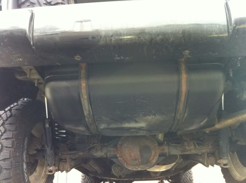

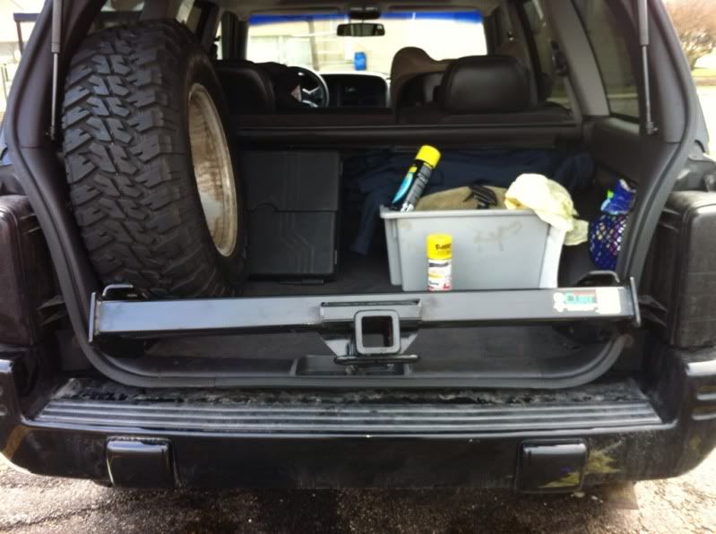

So as some as you know, I just recently bought a Curt trailer hitch off of Craigslist for $50 Retail I've seen them go Fro $200... So not to shabby.
So before I even wanted to start to bolt up the hitch, I one week ago started hitting the studs on the fram in the rear with PB Blaster. I soaked them for about a week or so and today fianlly decided to take the old nuts off the studs. Let me tell ya, I'm glad I soaked them.. Those bolts with the studs were pratically fused togetger.. In order to break them lose, I had to tighten them is hard and as much as I could, them loosen them to break them free.. Once I did that, I could only loosen them a certain amount, spray with PB Blaster then tighten again. I repeated those steps a million times, each stud took me about 10 mins to get the bolt off. Thank god it was only on the drivers side fram rail, the passenger side frame rail, the nuts for the studs were missing.
As I was doing the drivers side I was really paying attention and it looked different from the passenger side, well that's bc the drivers side had part of a hitch mount connected to the frame rail. PO must have cut it off or soemthing?
So after I got all the nuts off and 1 bolt off, I cleaned the studs with PB blaster, cleaned them with a hard wire toothbrush and scrubbed them real good. After that I made sure they were clean again and I coated the studs on the drivers/passenger side with anti-seize for now.. I guess to prevent more rust.
Those of you with trailer hitches, when you bolted up your hitch, did you put locktite on the bolts and studs, or did you jsut put anti-seize on them?
Now all I need to do is pick up some hardware and bolt up the new hitch
Here are some pics..
All cleaned up and ready to go
