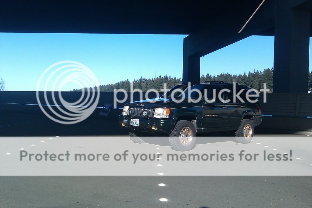

Took a photo of my jeep, and Drifted for over 500 miles 2 weekends ago in the snow we had! Such a blast helping people who got stuck, and drifting away!
96 ZJ limited 2" BB 245/75/16 Kenda Klevers, 200k+ miles, Winch Bumper, Aux Lights

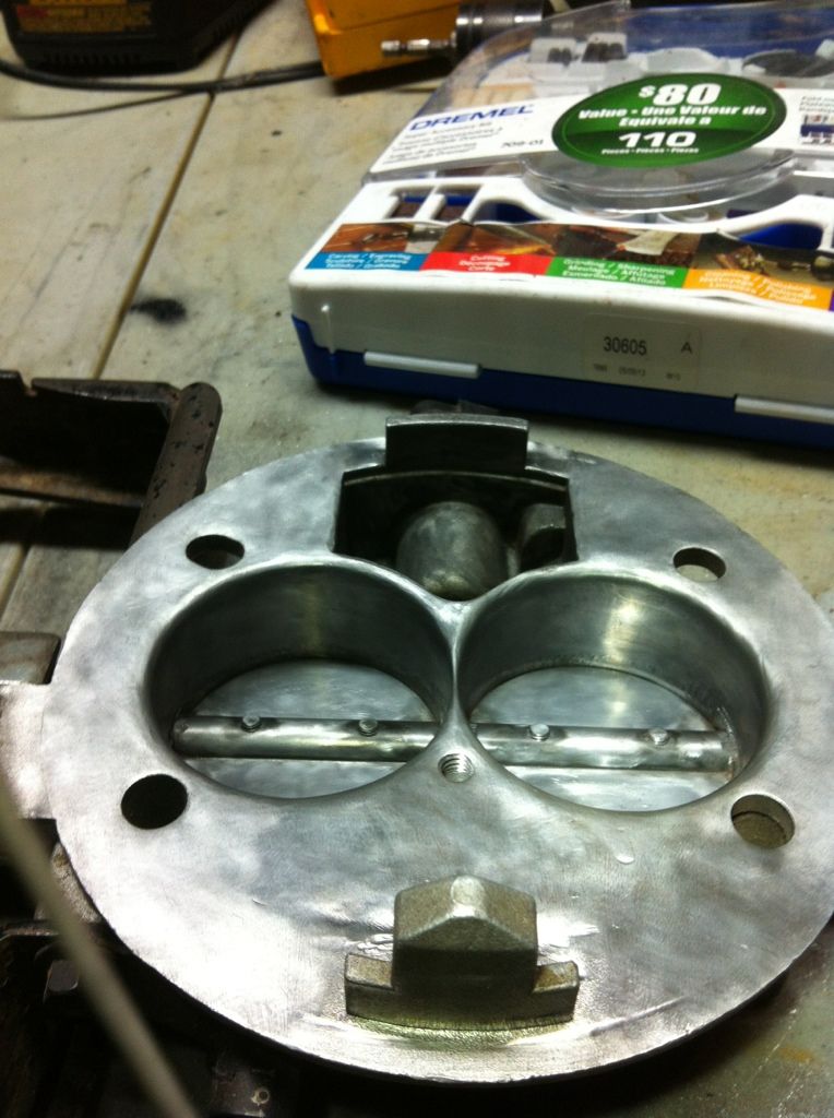

Originally Posted by MurdaJs View Post
That looks great. Who done it?
Me and my dremel, mainly the dremel, lol.
51mm hole saw for initial bore, wire wheel to clean deposits, to shape 'n smooth; tungsten carbide cutter, 60 grit drum, 120 grit drum, 350 grit spongy thing, polish pad
That's something I'd consider attempting to do on my own I think, as long as a tune or any other "supporting" mods aren't really necessary. How long did it take you?
The longer you take the better it looks First time it took me a full 24 hours over two days. You don't need a tune.
A hole saw and a vice is a good way to go. I used a brake honer and then sanded. Looks great and it's free! I didn't notice anything big but the throttle response was much better.
