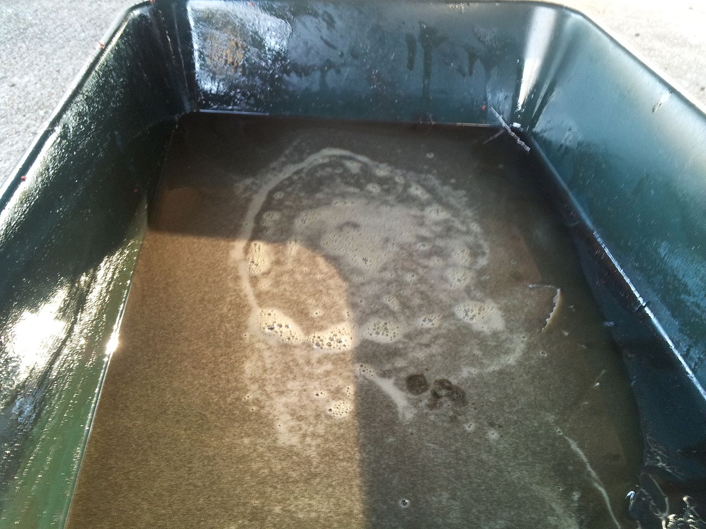

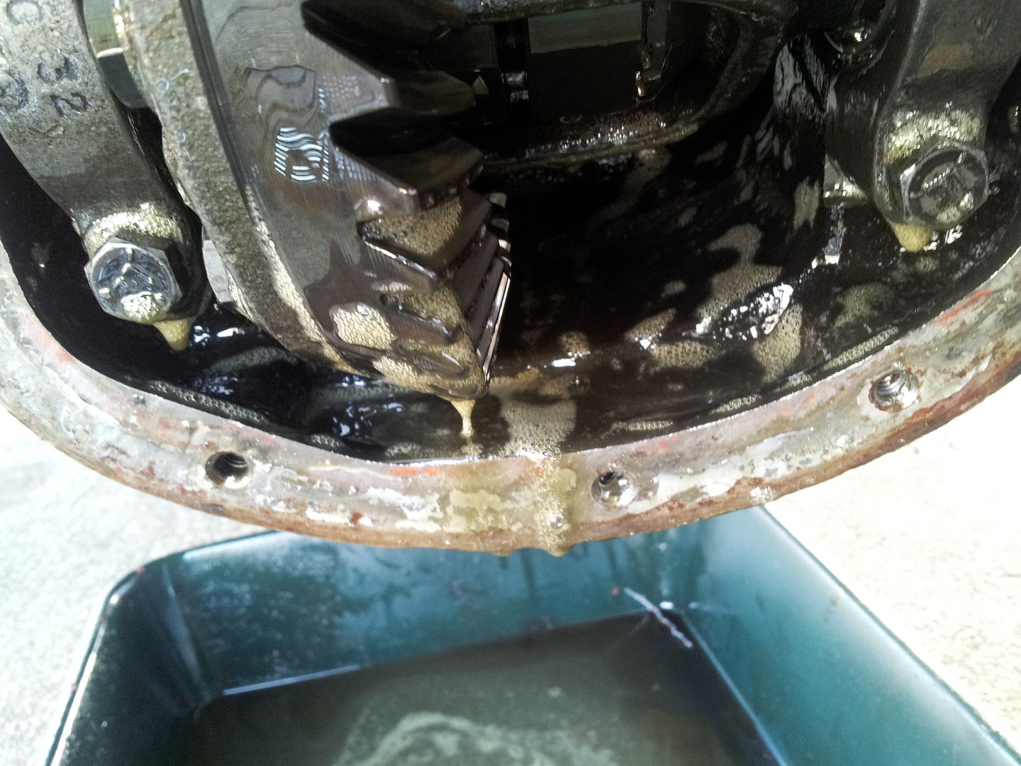

So I had an interesting problem yesterday as I was doing checking the fluids in my jeep. I first checked the oil, coolant, transmissiom fluid and everything checked out. So I crawl under my jeep to check the tcase and differentials. When I got to the front diff I tool off the filler plug, and to my surprise fluid started to pour out! Now this threw me off as I know I couldn't have added that much fluid into my diff. So I looked at the fluid and it appeared rather milky and odd. So I pulled the cover off and this is what I found
So I'm guessing that somehow water got in the diff, possibly from the snow last week. So yeah thats what I did to my zj haha

Breather isn't attached and you spent some time in the water. Brake clean the crap out of it and change the fluid in another couple hundred miles

Hopefully you didnt drive it a lot with the water in there otherwise you probably fried your locker too
