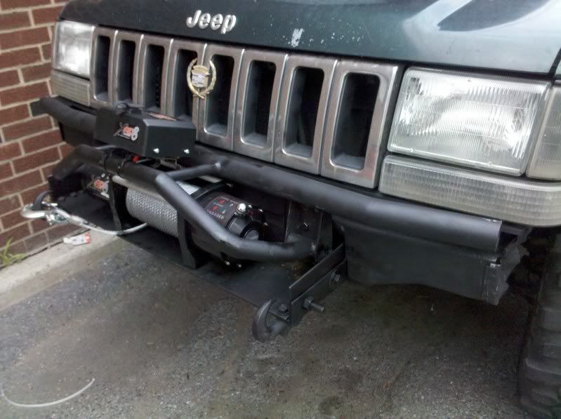

finished my winch mount and got everything wired up took 2 days for my winch to get here and about 3 to build the mount.

How are you going to mount the fairlead?

I'm going to add a bracket for it I I didn't realize how but the winch was when builting the munt so I kinda winged it but I got a 3 foot by 3 foot plate of steel ill make a bracket or something for it.

Looks like you could add a 10" wide plate thats welded to the top tube and bottom plate and cut out a hole in it.
Or, two pieces of 3/8" x 2" bolted on each side of the fairlead and welded on top tube and bottom plate.

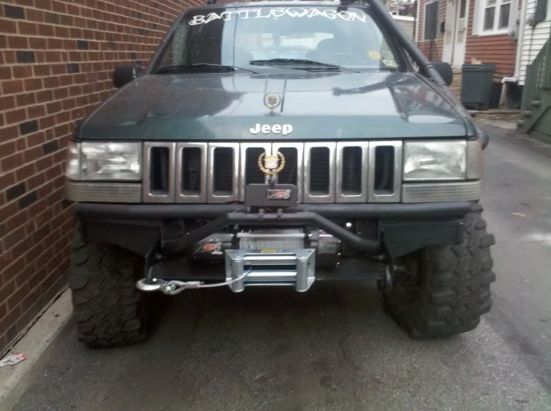

there much better,
