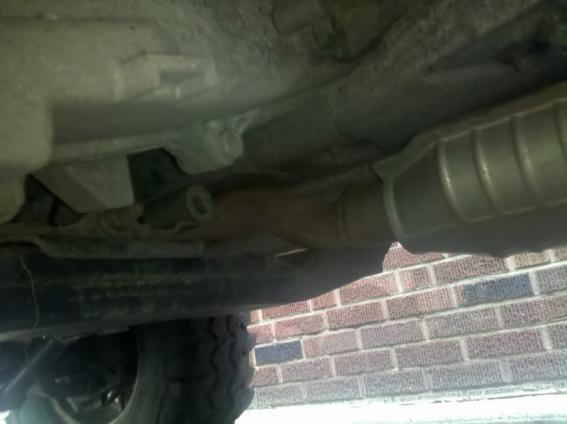

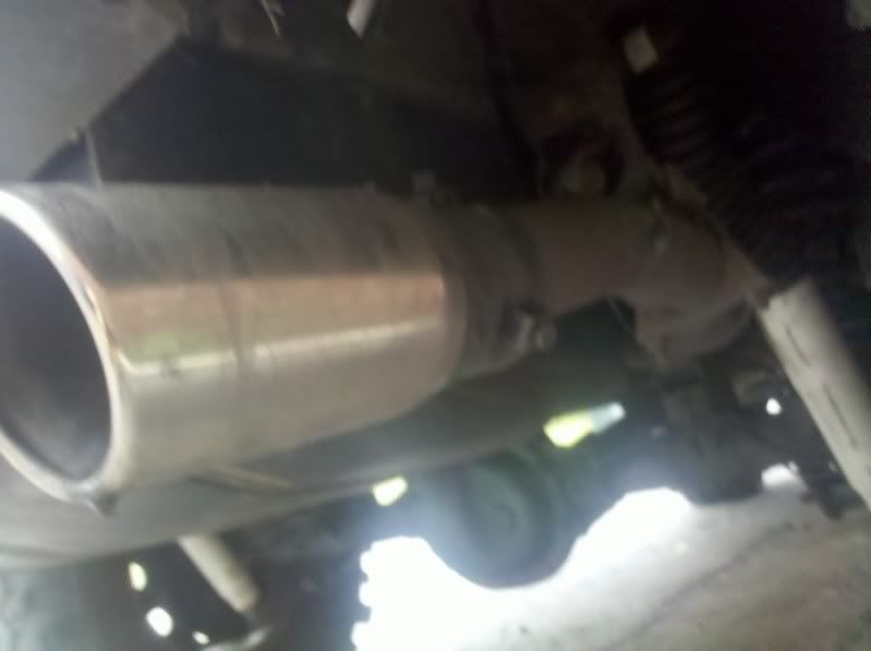

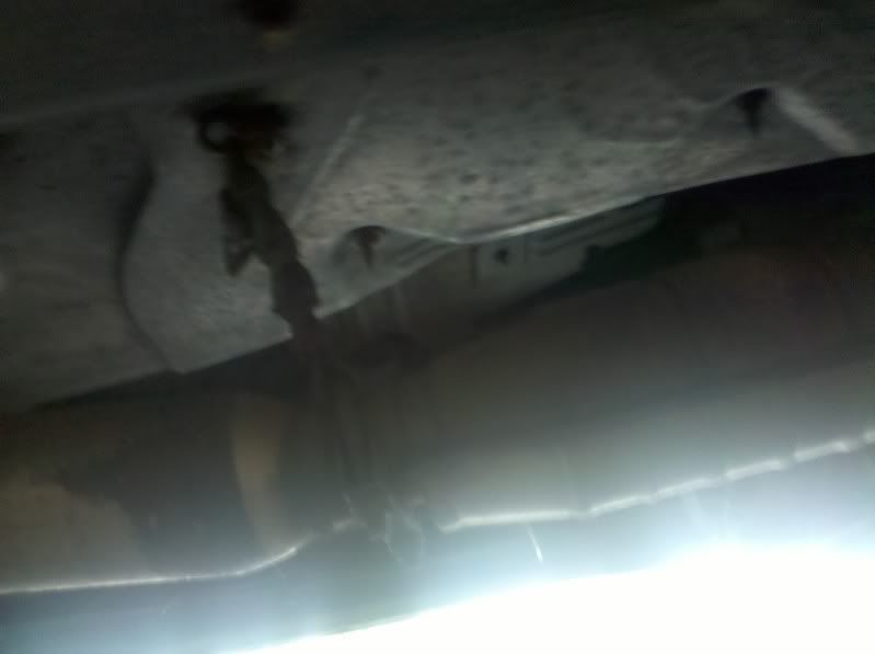

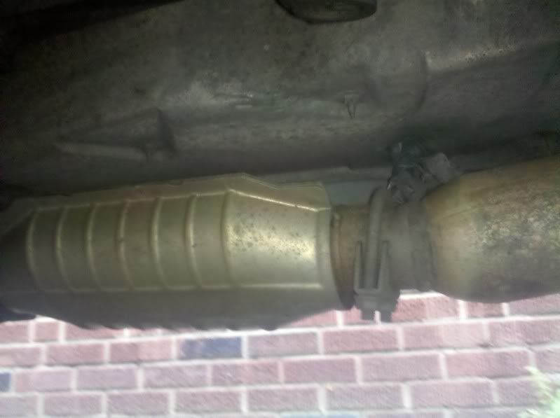

ill get ya a pic in a few minutes. its pretty ghetto fabulous but it works

I used a piece of chain and used an existing bolt to bolt the chain to and a exhaust clamp to hold it and in the rear ro keep it from hitting my shock. I parked it next to a brick wall and used a jack on the wall and exhaust to forcefully push the exhaust to the left away from the shock and used exhaust clamps on that as well it had enough play in it to let it move but not to much that it makes noise.

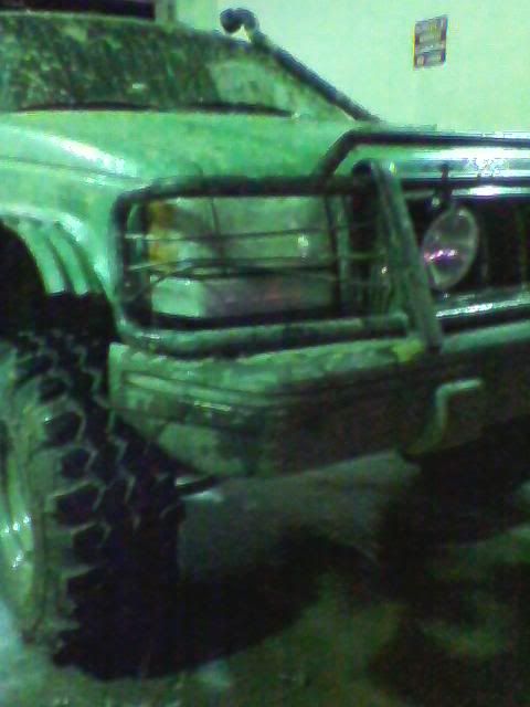

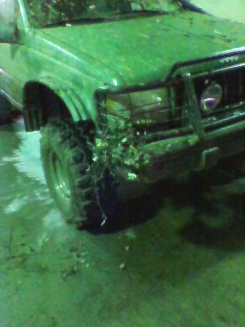

Decided to blow off some steam and test out the new bumper
