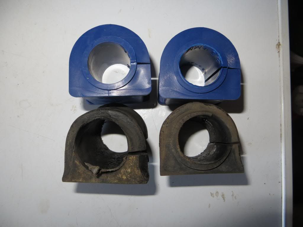

Replaced the front swaybar bushings with MOOG bushings. Dont know if you can tell that well but the factory bushings were screwed, I could just grab the bar and boggle it around in the bushings they were so worn and loose.
Feels a lot more solid now in the front end, no more clunking when I hit bumps, and a fair amount less body roll.
