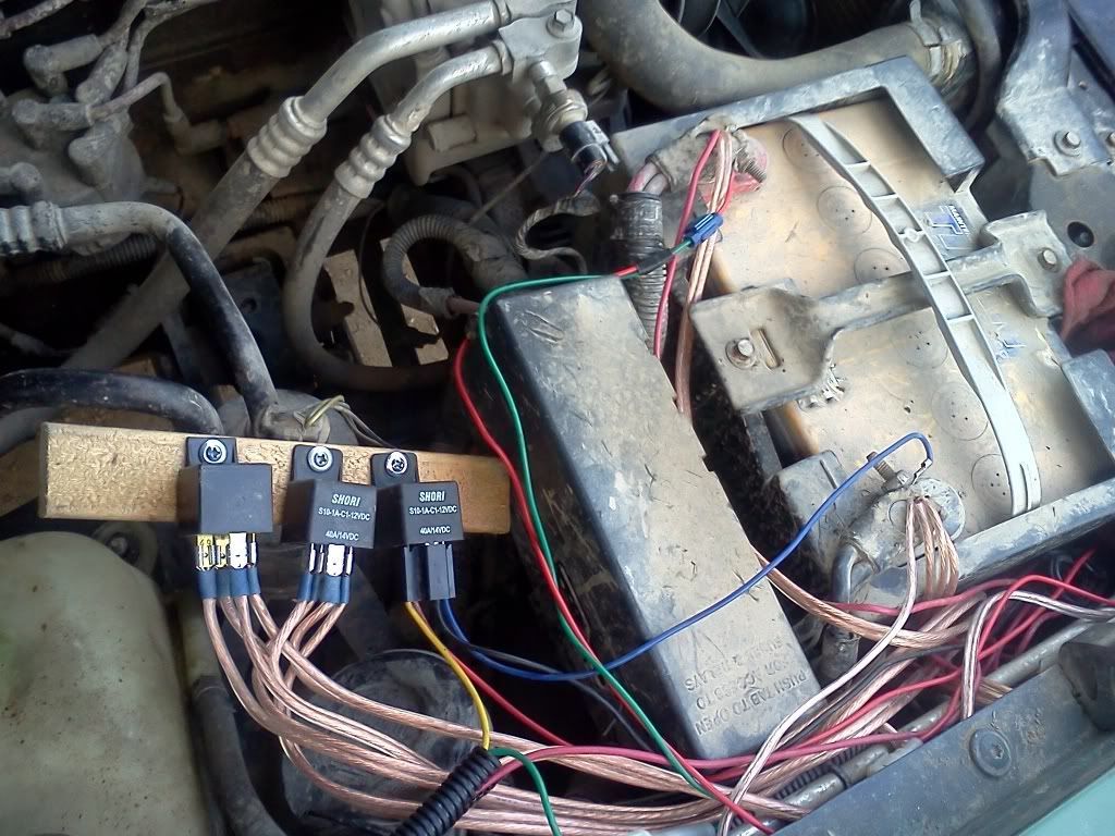

Is that really wired up with speaker wire?!?!?!?!?

The insulation on that probably isn't as durable as wire normal automotive wiring, but I bet the wire is actually a thicker gauge than normal wire. I would definitely loom that though for safety.
How is that connected to the battery? Is that just pinched between the top post and battery terminal? You'd be better off wiring in a distribution block to both terminals and powering and grounding everything properly.

Yes that is my efan wiring
yeah pinched (im more in to effectiveness more then quality)
I have used that speaker wire for years on other vehicles so I trust it
So just go pull another box and wire it up to the battery? Or the out put of the alternator

Doesn't matter, electrically the output of the alternator and the positive on the battery are the same thing
