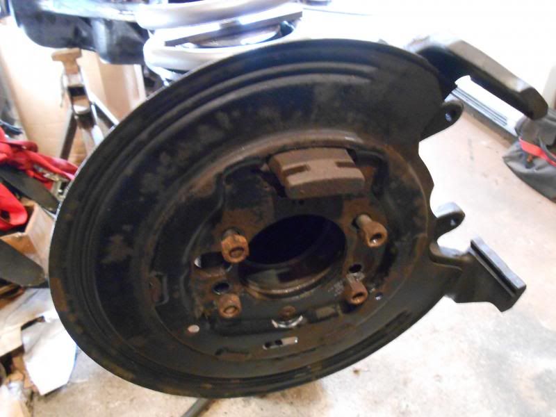

Modified my ZJ caliper brackets to bolt up to my XJ D44 i'm building..
