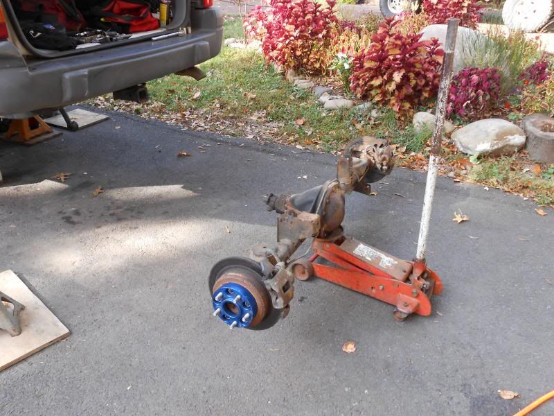

Pulled the D35 out, XJ D44 about to go in once I finish the ZJ disc install. Awaiting new RE coils..
Seems kinda odd to take one from an xj, won't you have to weld on brackets since xjs are leafed rear? Is there an advantage to an xj d44 to the zj d44 that came in the later v8s??

WJ4x4LIFE
Posts: 574
I was thinking the same thing, besides this I do not any other difference between them aside of two things XJ D44 is true vs ZJ D44A is alum. and leaf vs coil. On the ZJ D44A axle they stuffed steel tubes into it, which also takes the brunt of the axle wrap force, and this stresses the housing a lot more. This is part of what causes the carrier & pinion bearings to wear quicker than a regular housing. I believe that is why he is in for the swap with fab work, which is easy if you know what to do. I would still go with a ford 8.8 swap.
