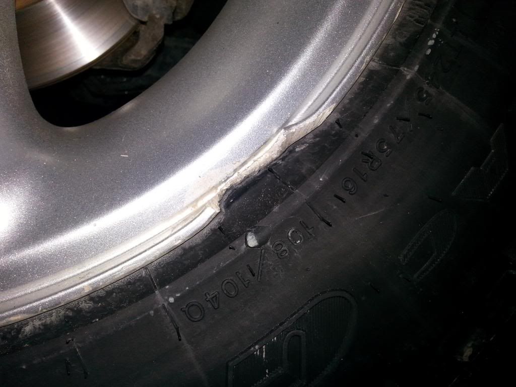

Wheelin a couple weekends ago and a rock jumped out and bit a piece off the outer rim. It held air fine since then but I don't wanna take any chances.

Here's a pic of it. Looks worse in person.

Ok, thanks for the rapid response... I agree, it would drive me nuts knowing I had a rim in that condition going down the road at 80mph...
Have you located a replacement? Not sure if RockAuto has any more in stock in that style... They only had a couple left the last time I checked because I need a spare... If so, they're wanting $127 plus shipping for one, iirc... Don't know why, but, every ZJ that I've bought has been missing the spare.... lol

They were able to reuse the wheel for my spare thankfully. I'll be on the lookout for a single wheel though. I found a set of 5 by me but he wants $350....yikes lol

Structurally, there is nothing wrong with that wheel.
That is only the wheel weight lip.
The bead area of the wheel goes down farther than what is missing.
It looks bad, but I've seen a lot worse, that's for sure.
Probably not legal for an inspection, depending on your state's laws....
As a spare, that will do just fine.
Still sucks though...

Yeah definitely does suck. If I damage another one bad enough that'll be my excuse to get some steelies and 32's ;-)

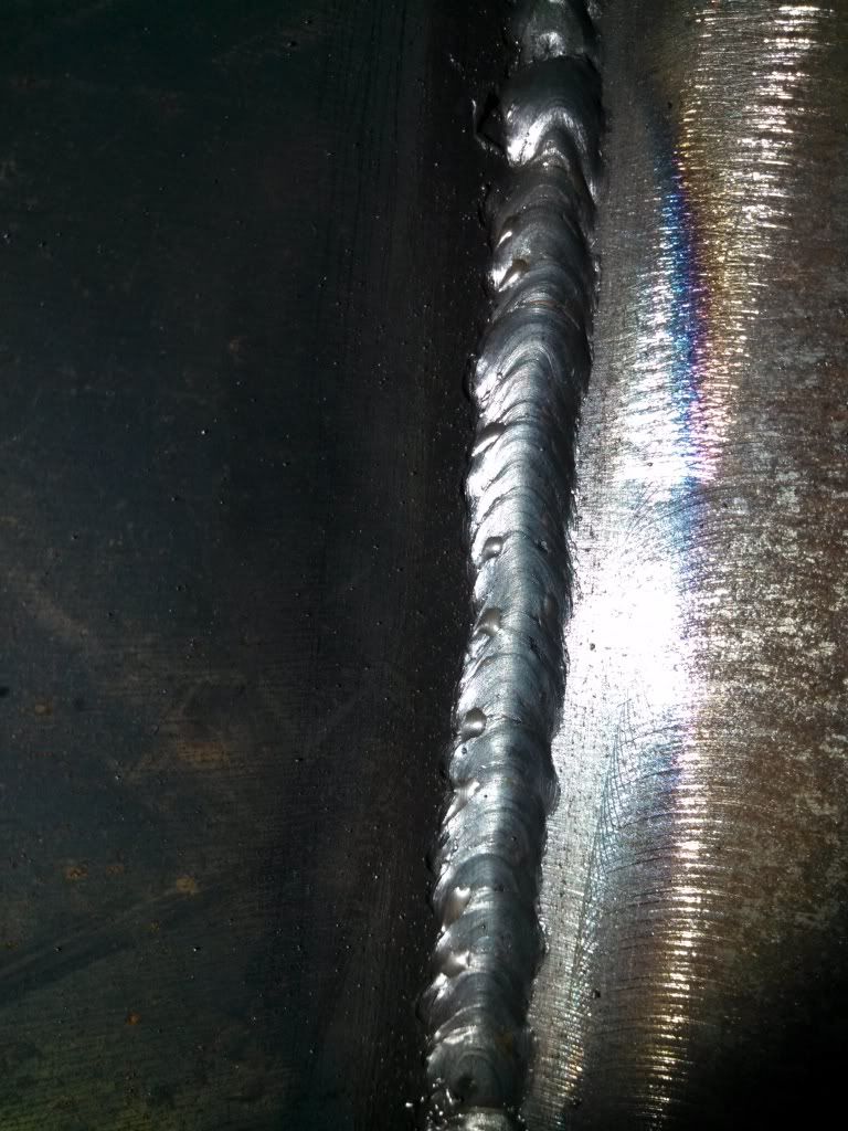

Started welding my Flatland 4x4 bumpers together. I've only got about 1 hour of MIG experience and about 18 hours of TIG experience. I was using MIG to do this.
