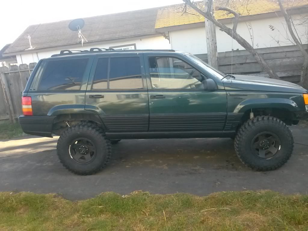

Nice always nice to do it yourself. I put stock 5.9 ZJ front coils in the rear which gave me 4", Rubicon Express rear track bar, Rough Country upper and lower arms in the back, stock JK Rubicon shocks in the back, front is 3" Skyjacker coils with a 1" puck, Skyjacker trackbar, stock JK Rubicon shocks, Rough Country lower arms stock uppers. Total investment on the lift is less than half what you paid. Sometimes its worth it to build your own kit and shop around find stuff cheap on forums.
5.9 front coils $ Free
Front 3" Skyjacker coils $ Free
1" pucks for the front $15
Rear Rubicon Express adjustable bar $65 NEW on Amazon
Front Skyjacker Adjustable high mount bar $100 used on CL
All 6 brand new Rough Country fixed control arms $150 on one of the facebook jeep pages
Used low mileage JK Ruby shocks $30 for all 4

Green ZJ is mine
