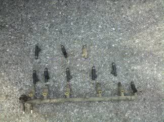

did the same thing but used 2.4 stratus injectors free as well works great with the 5spd heres a few pics to show the difference. I do not think neon injectors will work they are shorter then the 2.4 stratus ones i compared them at the junkyard.

I have seen a few people talk of changing the injectors. Can you describe the process of selecting injectors, why you chose what you did and how difficult the install is?
Also, the 9er I just got had bad gas... A friend said that the reason it is not firing right away is that the injectors may be plugged. it does run great after it starts. Any thoughts on that?

i also did alot of research on the injectors the 2.4 stratus and cirrus injectors are a direct swap just have to get 2 off another motor since the 2.4 is only a 4cyl its a simple as removing the fuel rail and pulling the old injectors out and putting the new one in its a very simple swap. I notice i have alittle bit more power when in second gear my jeep seemed to bog before now it runs great.
